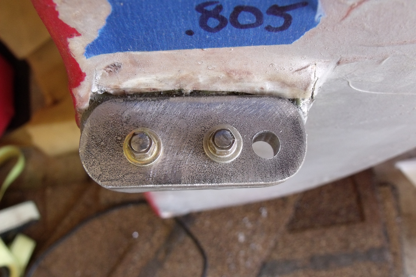

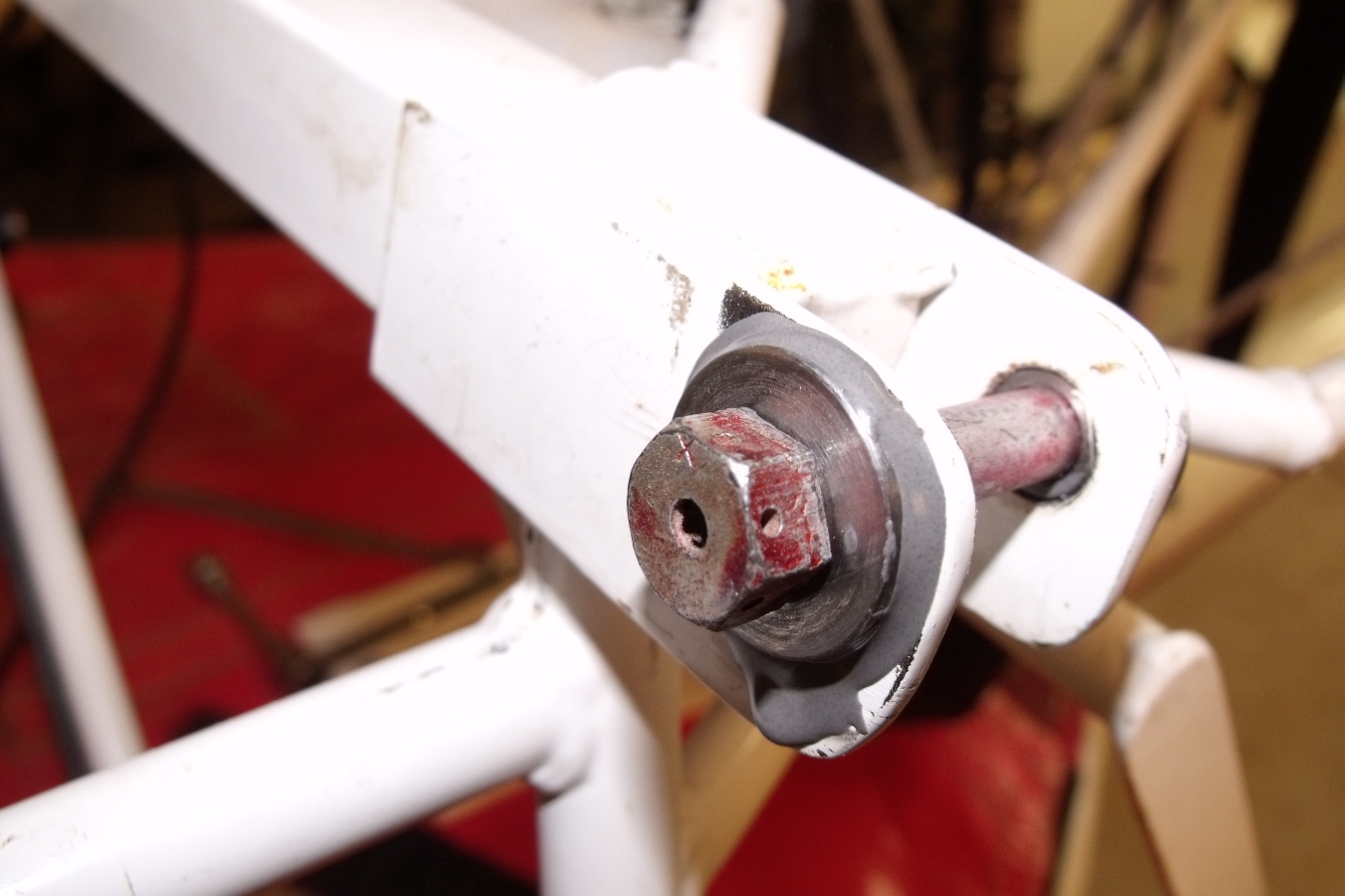

As of the last flight when I had the horizontal stabilizer lowered to lowest position that the bracked would allow and I was slowly adjusting the flaps and ailerons to make sure they were neutral to slightly reflexed. There was some improvement, but if I let go of the stick the nose would still begin to drop. I was out of adjustment on the flap pushrods, so I put the plane away for the night and began taking measurements. Wings s/b 2.8 to 3.4 degrees, are 3.45 and 3.75 degrees, horizontal stabilizer s/b -6.1 degrees, is -6.9 degrees. This is all referenced to the engine mount set at 0.
Out of curiosity I measured the bottom of the cockpit at the nose cone and at two points aft of it. Those angles were 2.9 degrees at the nose cone, 1.1 degrees just aft of the nose cone, and -1.75 degrees on the center longeron approximately even with the pilots seat.
The next morning I called Spruce to get some tubing for new flap push rods and then to Bryan Melbourne for his take on the situation. Bryan convinced me that the wing incidence had to be lowered to the least limit and I spent a couple of days trying to find a welder with a portable TIG. When that didn't happen I came up with a way to fill the holes and attach a plate to either side of the wing bracket.
The amount of lowering needed amounted to .375" on the right wing and .500" on the left. I machined a plate for the forward side of the plate from 3/8" 4130 so that it was .11" thick with a 3/8" boss sticking up .25". The boss would go through the old mount hole. The plate on the aft side is 3/16" 4130 and has counter sinks at the bolt holes for the boss on the fore plate and the bushing I put through the original IIIC mount hole. The plates are attached with J B Weld and two NAS flat head bolts on each wing.
On the spar carry through on the fuselage, I drilled the holes out to 7/16" and made flanged bushings that are a press fit. To seal the area under the head I used J B Weld again.
So, at this point, the wings are back on and the new flap push rods are made and installed. The old gap seal, which only fit in a token manner before, now doesn't fit at all. I was hoping to fly this morning before the wind picked up and the thermals began popping off, but I decided to rework the gap seal and hope for light winds tomorrow morning at dawn.
To Mark IIIX builders, you may notice from the pictures how high up the wing mount holes are on the spar carry through tabs and the wing tabs. The IIIX requires the wings to be mounted at such low incidence that you can run out of tab if you are not careful. If the holes had been located in the center of the spar carry through tabs more edge margin would have been available on the wing tabs. When you mount the wings, try to make the holes in the spar carry through in the center of the tabs or slightly lower than center.

PostPosted: Mon Jun 06, 2011 1:18 pm    Post subject: MkIII Xtra Reply with quote
Rick,
  Nice job of relocating the wing's tab holes & tabs.
  IIRC, and I do, your reference to the hor. stabs angle of -6.1 is wrong.  That is the boomtube's
angle.  The hor. stabs are supposed to be -4.6.  Of course, we're ALWAYS referencing that
starting point of "0" degrees for the motor mount.
  I have a chart I put together a couple of years ago that has all kinds of various angles for the
Xtra.  But, I put this chart together before I knew that the motor mount had to be leveled, so for
lack of any better idea, I asked the guys to set their main wings at "9" degrees.
  After I built the chart, I found out later that Xtra's are advised to use a precise angle setting
procedure.  My chart doesn't have much value anymore, since Kolb Co. has a specific plan
to address angles and incidences.  (yay!)
  Regarding your hor stabs ACTUALLY being -6.9....something's screwed!!  No bleeping way!!
Not unless Kolb Co. is handing out new angle numbers!!
  When I talked to Bryan Melbourne about how to go about setting up the plane (as an Xtra), he
said;
1) set motor mount to pure level (left & right, & for and aft)
2) boom tube SHOULD come in at -6.1 (mine was spot on!)
3) main wing are to be set at +3.4 degrees.
            (I have later found out that +2.8 was also 'suggested'.
            So +2.8 to +3.4 is the acceptable range.
                      (Mine are 3.4.......exact!)
4)horizontal stabs are to be set at -4.6 degrees.
             (I have adjustable mounts  that will let them vary
              from about -4.0 to -5.5 degrees.)
5) dihedral "should be" around +1.6 degrees
               (Since my wings were already mounted years ago,
               I decided NOT to change the struts lengths, so this had the
               effect of creating more dihedral than the stock Xtra's
               OEM recommended angle.  I ended up with +2.7 degrees
               dihedral)
  You ought to call Bryan and verify that horizontal stabilizer number!
  It looks like you're well on your way to getting this thing ironed out.  Good job.

The reference to my talk with Bryan was poorly stated for the information I was trying to convey. What I was trying to say was that lowering the wing incidence works to negate the downward pressure exerted by the "X" fuselage pod, that several builders have done them incorrectly and welding up the holes and remounting them solved the problem. So, I got up before dawn, made final adjustments to the flaps to eyeball them in to being equal side to side, and went flying. It was done sans any center gap seal at all. The wings are now so low that the old one can't be hacked up to even mount it much less offer any kind of drag reduction.
Immediately after take off I was disappointed to find that there was little improvement in pitch. As I passed over the departure end of the runway and started searching the pattern just in case someone else was up early to come visiting, I noticed that I had neglected to pull on any trim. Pulling the trim handle meant slipping out of my shoulder harness to reach it (I fly right seat) and once adjusted, which yielded a small improvement in back pressure on the stick, I couldn't refasten the buckle. This was now going to be a flight around the pattern, rather than the slightly longer one to get a little more altitude and try nudging up to stall speed to see how optimistic the airspeed indicator is, that I had planned.
Being a windy morning, I started my turn to base from abeam the runway end, made my turn and slid along at a roughly 45 degree angle to my actual direction of travel until it was time to turn final. I was quite high, but I counted on the wind gradient to give me a steep approach angle even without flaps and at 600 feet and roughly about the same from the end of the runway, I pulled the power to idle. SURPRISE!, all the back pressure went away. As a glider, the airplane is now completely neutral. Landing number seven was the most pleasant I've made in Ken's airplane. While I still kept the airspeed up to 60 indicated, I was able to relax my death grip on the stick and, for a few seconds at least, enjoy flying the aircraft.
So, the change to wing incidence seems to have alleviated the negative lift of the "platypus nose" fuselage pod and it appears I'm dealing with a thrust line issue.
John H., if you're reading this, try not to say "I told you so". He did, by the way, so I deserve it.
Anyway, even though the engine is 5/16" lower than the factory mounting for a 618 with the "E" gearbox, the combination of the extra height, 70" propeller, and changed thrust line from the IIIC seems to be the cause of the nose down pitch attitude.
Here are the angles as they are since I moved the wing incidence, adjusted for the motor mount being level.
Left and Right wing     2.8 degrees
Boom                        7 degrees
H Stab                      7 degrees
There are some small changes in the readings of the boom and horizontal stabilizers since the ones I took last. I measured each twice this time,  rotating the protractor 180 degrees in the horizontal plane and taking the average of the two measurements.
As a firm believer in doing the cheapest "fix" first, I'm going to lower the front of the motor mount to change the thrust angle by the difference between the C and X wing incidence.
It's not forecast to be flyable, at least for test flying, again until Thursday at dawn so I'll know more then.
