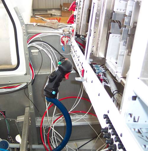

Someone recently asked me how I resolved our Infinity grip mounted stick hitting the lower panel. My answer was I will know in two weeks. Well folks, finally something done ahead of schedule...
            The grips do hit the lower panel as we suspected. The sticks need to travel about 1/8" further than the panel allows. Additionally we would want some extra clearance for comfort. After spending some time accessing the situation we figured there were a couple of options at this point in the build.
            Option 1 modify the down travel on the elevator stop. From what we measured our current down travel is 25 degrees. To get the full set back needed we would have to take the travel down to ~19 degrees. This was less than 0.75 inches of travel on the Horizontal Stab and would have solved all the stick clearance issues. That being said Van specific a minimum of 20 degrees and as we are not re-engineering the aeronautical portion of this aircraft that modification was a no go even though I hope to never need full forward deflection.

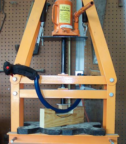

            Option 2 turns out to be a simple fix. We pulled the stick out of the fuse and placed it in a hydraulic press to bend the curved section of the stick. There was very little bending required to provide the clearances needed and nothing aeronautical was modified. The change is unnoticeable from the pilots/co-pilot seated position.
            Option 3 is to plan ahead like Deems did and modify the stick BEFORE it is powder coated, grip fitted and wires run. Fortunately our adjustment did not put a single scratch on the stick and the entire correction took less than 90 minutes including making the wood jig to bend the sticks. (All times exclude head scratching)

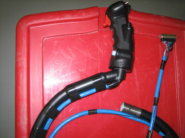

I had the same stick interference with my panel from Lancair. The Infinity grips are much taller and cause this problem.
I have posted this in the past but thought I would post again. I decided to cut my stick near the top of the curve. I then purchased the exact same steel and wall thickness only it was a larger diameter so it would slide over the stock stick. I can't remember the type of steel, I just called Van's and they knew exactly what it was.
Luckily one of the helicopter maintenance companies here at my airport has a certified tig welder and he charged me $40 to weld up both sticks. He did an amazing job.
I don't even notice that the stick is slightly angled but now it is clear of everything.
I don't think anyone should mess with the controls and limit them even though full down will probably never be used.
My fix took a couple hours once I had the right steel tubing.
