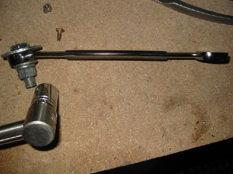

I just came across a great idea that I want to share with the group. There are a few times that a torque wrench won't fit on the nut/bolt (namely engine mounting bolts, prop nuts, supporting the starter/alternator wires on the engine case). Instead of purchasing expensive extensions or welding something up I found that if you take an ordinary combination wrench and put a bolt/nut with washers through the closed end you have a perfect extension. And you get to keep your wrench intact. See photo below.
You'll need to set your torque wrench to the appropriate setting when using an extension. If you don't trust yourself with a calculator here's a website that will do the math for you:
http://www.norbar.com/torquewrenchextensioncalculator.php
This is too easy, but I struggled with a few of these before I came across this idea, so I figure it's worth sharing.
Jim McGrew

Jim, that is a genius idea! I cobbled something together when
I did my prop bolts, and used an online torque calculator to
verify my own calculations on torque, but this wrench extension
is pure genius compared to what I did. I'm going to put this
directly into the tips section on my site for permanent viewing
and for those who only get the daily digest.
http://www.myrv10.com/tips/generaltips.html

While it is an inventive way to do it, I wonder about the impact of the
angle on the wrench shown, and might point out that a set of crow's foot
wrenches from Sears isn't all that much money. The crow's foot works
fine on Hartzel props.

PostPosted: Sat Apr 29, 2006 6:38 am    Post subject: Torque Wrench Extension Reply with quote
Jesse,
This falls in the category of waxing philosophical on a subject and that doesn't help get my plane in the air any faster BUT I'm totally with you. I struggled with that as well so here goes.
If you are working with a beam type torque wrench you must hold it on the handle and center the handle on its pivot in order to get an accurate reading, in this case it is easy to understand why the calculation needs the torque wrench length. With the micrometer or "click" type torque wrenches you don't necessarily have to hold it by the handle to get an accurate torque because the spring is set to the value you want - that is, unless you are using an extension.
Hang with me and please excuse the math, this is how I understand it. Consider the following 2 cases:
You are using a 20 inch long micrometer type torque wrench set at 100 in-lbs attached to a 10 inch extension.
1) If you hold the torque wrench by the handle you must apply 5 lbs of force to create 100 in-lbs of moment (torque) at the head and cause it to click (5 lbs x 20"). At the end of your 10" extension you are creating 150 in-lbs of torque (5 lbs x 30 inches).
2) If you "choke" up on the torque wrench and hold it, say, 10" from the head you must apply 10 lbs of force in order to get it to click at 100 in-lbs. Now at the end of your 10" extension you are applying 200 in-lbs of torque (10 lbs x 20 inches)
As far as using the extension other than straight - I'm not an A&P, but I am an engineer and the math tells me that bending the torque wrench does make a difference. Your moment arm now becomes the hypotenuse of the triangle created by the torque wrench and extension. The further you bend the extension the shorter your moment arm becomes and, thus, the less torque you have at the end of your extension. This is a minor correction until the angle starts getting beyond about 45 degrees. I will skip the geometry involved. Consider the case if you bent the extension all the way back toward you, aligned with the torque wrench... now the moment arm is equal to the length of the torque wrench MINUS the length of the extension.
Sorry for the dissertation. I had to prove this to myself before I torqued my prop bolts.
The bottom line: The website calculation works for a straight extension.
Jim

PostPosted: Sat Apr 29, 2006 6:45 am    Post subject: Torque Wrench Extension Reply with quote
I had a few places where the crow's feet didn't work for me. I won't get into details... in my opinion the angle of the wrench doesn't make an appreciable difference.

PostPosted: Sat Apr 29, 2006 6:56 am    Post subject: Torque Wrench Extension Reply with quote
Great Idea! I used a expensive Crows Foot but had to go and shop for
it. This would have done just fine.

PostPosted: Sat Apr 29, 2006 7:18 am    Post subject: Torque Wrench Extension Reply with quote
A note about the crow's foot. I think I used one on my prop bolts,
but it was hard to get something that stuck out far enough away
from the prop hub to allow the wrench to fit in good too.
Ideally, you'd use an extended crows foot type arrangement, which
is a tool Hartzell sells. But, what he did with the bolt
and open end wrench essentially duplicates the extended crows foot,
and from what I can tell, I think that's probably the simplest
way to get those prop bolts tightened.
Jim McGrew
#40134 - Fire Wall Forward

Jesse,
handle on its pivotin order to get an accurate reading, in this case it is easy to understand whythe
calculation needs thetorque wrench length.With the micrometer or "click" type torque wrenches
you don't necessarily have to hold it by the handle to get an accuratetorque because the spring is
set to the value you want- that is, unless you are using an extension.
cases:
inch extension.
moment (torque) at the head and cause it to click (5 lbs x 20"). At the end of your10"extension
Jim
40134
welding something upI found that if you take an ordinary combination wrench and put a bolt/nut
with washersthrough the closed end you have a perfect extension. And you get to keep your
worth sharing.
