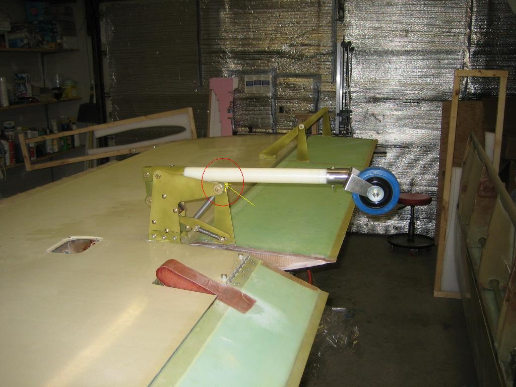

Just curious why the full depth available in OR1 and the wheel fork are
not utilized by the nylon legs. The nylon rod is inserted only part way
into the sockets and the bolt holes are drilled just 5mm from the rod
ends. This design seems a bit strange to me.
I am thinking of buying slightly longer rods and using the full socket
lengths for better support of the legs.
Also, why nylon? It would seem that a hollow aluminum tube or even PVC
might provide better strength and ligher weight.

Andrew
nylon was the only material that withstood being bent almost 90 degrees
without permanent deformation.

I too was surprised at what you've determined...particularly if the rod
is subject to the 90 degree bending which Graham describes.
If (presumably momentary) bending is to the 90 degree extreme, I can't
help but wonder if the forward portion of the speed kit fairing doesn't
get ground away...(?...Does this in fact occur?)
Since mono-flyers have advised to NOT make the final drilling of the
rods until the plane is sitting on the gear w/ full weight in order to
assure that the outrigger wheels can both touch the pavement at the
same time for optimal ground handling, I will probably be ordering
longer lengths of rod in order to effect full bearing within the wheel
fork...although I have no idea whether mono-flyers routinely have done
so.
Any comments from currently flying mono-guys?

My outrigger legs seem to go all the way into the OR1 forks. If you're not careful
taxiing on narrow paved taxiways and get an outrigger off the pavement, the outrigger
will bend considerably as it steps back onto the pavement and can scrape the OR1
fairing, no big deal tho. I sure wouldn't want aluminum fork legs!

I was not aware of this advice to not drill the rods until the final
phase. Well, mine is done, so I may have to buy a new set of rods when
the time comes.

My builders manual does not say to wait until the final phase to drill the rods and certainly nothing about being sure that both outrigger wheels can reach the ground when rigged.
Should the leg length reach the ground when the aircraft is empty? With one person on board or two? With a full tank of fuel?
I drilled the legs to the measurement called for in the manual and since I put a tire (tyre?) on that is larger in diameter, my legs are probably too short.
Tom Friedland

IMHO it is best to have the legs an inch or so short when on level ground and loaded. If you get on grass and the main wheel is in a low spot the legs will drag, maybe a lot. If you are in any dished out area the legs are hard on the ground. I have no problem with the plane tipping side to side a few inches when ground handling.
Ken Carpenter mono N 9XS

The original length seems to work alright and will take 90 degs of bending
without affecting the ends. However, as the largest bending moment is at
the top, I would suggest you allow for a little more penetration at the top
rather than at the fork end.
William

If you are unluckily enough to ground loop in a strong cross wind, it is
very likely you will grind away the forward face of the fairing. I have
repaired my port fairing twice now!
I think you should be able to achieve both wheels touching with the standard
legs and as mentioned previously, it is not necessary to have full
penetration (if you will pardon the expression!) of the nylon rod into the
sockets.
My first pair of standard legs lasted for 1100 hours, but eventually took up
a permanent set into a curve, that reduced their effective length, so I have

Here is a pic that shows the problem area. I have checked the
dimensions and they all appear to be correct, to within a millimeter or
two in the worst case.
Any insights you can offer would be appreciated. Thanks.
Andrew Sarangan
http://www.sarangan.org

fklein(at)orcasonline.com Guest
Posted: Wed May 23, 2007 11:01 am Post subject: Outrigger legs |
Andrew,
Your pix of your outrigger looks a lot like mine...you'd previously
said that the interference you've encountered keeps the flaps and
ailerons from aligning...I'm not clear as to why that is the case.
What happens when you flip the wing over?
When you do so, be sure that your wingroot template is in place and
grabbing the TE of the flap and that the outermost TE of your aileron
is aligned w/ the BOTTOM of the wingtip and clamped to hold it in
place. My hunch is when this is done, alignment will be fine and you
won't experience any interference from the outriggers.
I did my wings simultaneously as I was concerned about maintaining
symmetry...
Fred

asarangan(at)YAHOO.COM Guest
Posted: Wed May 23, 2007 1:25 pm Post subject: Outrigger legs |
Perhaps I am splitting hairs trying to get everything perfect. When I
retract the flaps, the max up-travel is being limited by the nylon legs
coming in contact with the FL3 plate. After repeated flap operation, I
can even see a small ding mark on the nylon leg. This was a surprise to
me because I did not expect the nylon legs to function as any kind of
travel limit.
When I did the alignment, I painstakingly set the gap between the
flap's leading edge and the vertical closeout to be 5mm. But with the
nylon legs attached, that 5mm gap seems to be a moot point. I can't
retract the flaps to reach that 5mm gap anymore. It is more like 10mm.
This is the reason the flap and aileron don't perfectly line up now
because I did that alignment with the nylon legs off, and a 5mm gap.

h&jeuropa
Joined: 07 Nov 2006 Posts: 635
Posted: Thu May 24, 2007 4:56 am Post subject: Re: Outrigger legs |
Andrew,
We had the same problem when we started flying last year. We talked to Andy and filed a little off FL3 and even opened up the slot in OR5 (with Andy's OK). Our outrigger still didn't seem to retract fully but we flew anyway.
Now during our rebuild we fitted new OR5 to have the proper slot length and spent a lot of time fiddling with the outrigger assembly. We finally noticed that OR4 is hitting OR6 which prevents the outrigger from fully retracing. OR6 is not symmetrical. We found that flipping it over so short end (length from hole to end of block) faces aft gave us a little more movement of OR4 and results in the outrigger coming up properly. We suppose you could file some off OR4 but the manual cautions against this (page 9-10 Issue 2). Fig 15 on page 9-9 shows the relationship of OR4 and OR6 with the outrigger retracted.
Jim & Heather
| - The Matronics Europa-List Email Forum - | | Use the List Feature Navigator to browse the many List utilities available such as the Email Subscriptions page, Archive Search & Download, 7-Day Browse, Chat, FAQ, Photoshare, and much more:
http://www.matronics.com/Navigator?Europa-List |
Back to top |
Posted: Thu May 24, 2007 6:03 am Post subject: Outrigger legs |
Great, thanks!! I was starting to get worried if I was doing something
wrong, but I am glad to hear this from you.
--- "h&jeuropa" <europa(at)triton.net> wrote:
Andrew,
but we flew anyway.
retracted.
Jim & Heather
