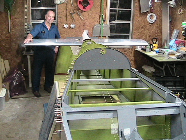

Got the stabilizer mounted last night (see photo). Next big issue is how to get the cutout done right where the nose of the stab fits against the aft edge of the rear top skin. Any hints?
Ed

wjones(at)brazoriainet.co
PostPosted: Wed Jun 27, 2007 1:26 pm    Post subject: CH601 hung up in a tree Reply with quote
Hi Ed ,looking like an airplane ,nice work .I am at the same stage ,dreading to make the cut-out . If you learn anything please pass it along .

Jaybannist(at)cs.com
PostPosted: Wed Jun 27, 2007 1:51 pm    Post subject: CH601 hung up in a tree Reply with quote
Ed,
I made a rough template out of bristol board (about the same as manila folder material) and fine tuned it by adding strips of masking tape to fit the curve. I transferred this to the rear top skin and made the cut. It fit the stab leading edge perfectly. I removed the stab and later riveted the rear top skin in place. Still later, I tried to reinstall the stab - and I couldn't get it in the beautifully coped rear edge of the rear top skin. I had already riveted the stab attach brackets in place and that caused the conflict. I had to trim off that masterful rear edge of the top skin, and make an aluminum filler that could be attached with screws and plate nuts after the stab is in place.
Some posters (and ZAC) have said that this is not a problem. Just watch out!

dredmoody(at)cox.net
PostPosted: Wed Jun 27, 2007 7:00 pm    Post subject: CH601 hung up in a tree Reply with quote
Yep Jay. This is a concept that dentists are acutely aware of. It's called path of insertion; we deal with it all the time on bridegework. The dirty little secret is that the geometry of the stab attach brackets will not allow the removal of the stab in any direction other than up or forward. Since the rear top skin must fit very closely to the nose of the stab, forward movement is out of the question. Since no one wants to drill out the rivets holding the rear top skin or the stab brackets, the only direction left for the stab is straight up. So if the rear top skin is cut to curve over the nose of the stab you're screwed; it is on forever and can't be removed short of major surgery. What you had to do is the only way I can see other than making a fairly sloppy cut with a lot of gap over the stab.
Therefore unless someone comes forward with a miracle solution, I'm going ot make a very close fitting cut where the rear top skin fits under the nose of the stab but from where it contacts the leading edge, the skin will be cut almost straight upward. I will make a piece of .016 to connect from there back to the rudder fairing. that piece will rivet to the rudder fairing and screw to nutplates at the rear top skin.
BTW I assume we have to make some sort of L brackets to secure the rudder fairing to the top of the stab with nutplates but I haven't seen any instructions regarding that. Have you? I'm sure they're written somewhere, but where?
Got enough rain yet?
Ed
japhillipsga(at)aol.com
PostPosted: Thu Jun 28, 2007 11:37 am    Post subject: CH601 hung up in a tree Reply with quote
Ed, if I remember you rivet pieces of "L" angle on the top of the stab that fit inside the fiberglass cover. I built by the plans and rivetted the cover down under the turtdle deck skin and to the brackets. When at annual I needed to see inside there to inspect so I drilled out the rivets and reinstalled with nutplates. Would have been a lot easier before I painted, Best regards, Bill
