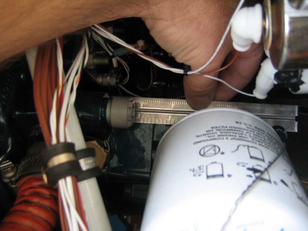

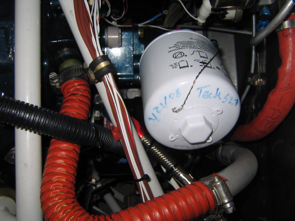

I'm not sure if Casper Labs is different but here is a B&C adapter with a
1.5" spacer on my -10.

 Filesize:  98.07 KB
 Viewed:  576 Time(s)
 Filesize:  76.19 KB
 Viewed:  608 Time(s)
