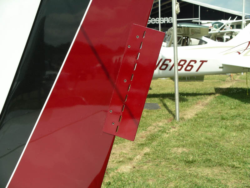

[img]cid:part1.06080908.01090301(at)eskimo.com[/img] The Bonanza has a 2.25" by 11" trim tab held onto the rudder by a comparable sized strip of aluminum on each side riveted to the rudder and to the trim tab.

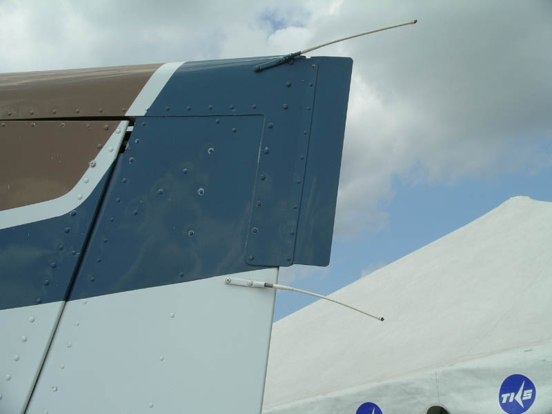

[img]cid:part2.01030908.05090104(at)eskimo.com[/img] The Cirrus has a 2.5" by 8" tab riveted to one side of the rudder.

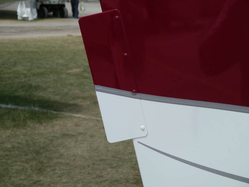

[img]cid:part3.02030405.01080004(at)eskimo.com[/img] The Columbia/Cessna 350/400 has the trim tab riveted to one side of the rudder. It is also slotted as shown in the picture.

[img]cid:image002.jpg(at)01C9009F.59C03AA0[/img]The Cirrus has a 2.5" by 8" tab riveted to one side of the rudder.
[img]cid:image003.jpg(at)01C9009F.59C03AA0[/img]The Columbia/Cessna 350/400 has a 3" by 10" trim tab riveted to one side of the rudder. It is also slotted as shown in the picture.
