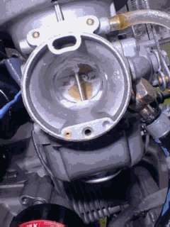

PostPosted: Wed Feb 11, 2009 2:12 pm    Post subject: Carb ice on a 912 Reply with quote
I don't know how this carb was iced, but it claims this is an example of
carb icing. It's from an ad for carb body heater. Thery fact that they had a
camera and an icy carb together at the same place makes me think it was
staged, but still; here is an icy Bing

PostPosted: Wed Feb 11, 2009 6:40 pm    Post subject: Re: Carb ice on a 912 Reply with quote
Ok here is a more official word even if I have to eat my own. I will always seek out a good answer and I admit I need to adjust my thinking some. Here is an answer from Eric Tucker from Rotax. I sent the picture to Eric and ask his opinion.
Hello Roger
Do I believe it, yes...in England they have high humidity and the temperatures that make any engine with a carburetor prone to icing. (Due point and temperature match) Any venturi that moves air will experience a temperature drop, if that drop occurs and brings saturated air into the engine venture at the freezing point of moisture, bingo carb ice. While it may be unlikely that a Rotax will ice, it can and has happened in my experience. In most cases the engine bay is so hot, due to the fact that most installations do not have baffles and very few OEM do any airflow testing, the engines are sucking hot air from inside the cowlings. Hot air robs a bit of power, but protects against ice. In the case of exposed engines, as in most UL applications, the operations are normally not in these conditions, it’s just too cold to fly in saturated air even at mild temperatures up to 70 degrees.
I personally like the hot water systems that they have developed, they do not cause a loss of power because they do not heat the air, they heat the carb body were the ice forms. In addition it should be noted that the guys in the UK who developed this are long time aircraft supply people and both of the principals happen to be engineers. They also developed the “soft start” module for the ignition. Rotax liked the idea so much that it will be built into the ignitions starting mid 2009.
Eric

PostPosted: Thu Feb 12, 2009 1:26 am    Post subject: Carb ice on a 912 Reply with quote
of carb icing. It's from an ad for carb body heater. Thery fact that
they had a camera and an icy carb together at the same place makes me
think it was staged, but still; here is an icy Bing
Dave
that's the photo Nigel Beale took and yes it was done on the ground
after an in flight occurrence. This was the trigger to develop the carb
heater.
Graham
