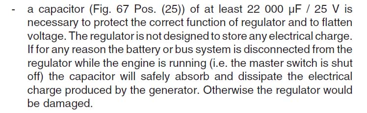

Hi all,
If the 22000 mF capacitor is broken the R/R can be burnt due to too much AC on the 12 V. (fig 52 pos 25 in the installation manual)

Correction on capacitor size: 22 mF...

craig(at)craigandjean.com
PostPosted: Mon May 04, 2009 8:42 am    Post subject: 912ULS integrated alternator question Reply with quote
The size stated in the installation manual is 22 thousand uF (microfarads)
(image attached). This is a fairly large electrolytic capacitor, probably
about an inch or so in diameter and 2 to 3 inches long.
"- a capacitor (Fig. 67 Pos. (25)) of at least 22 000 uF / 25 V is necessary
to protect the correct functioning of regulator and to flatten voltage. The
regulator is not designed to store any electrical charge. If for any reason
the battery or bus system is disconnected from the regulator while the
engine is running (i.e. the master switch is shut off) the capacitor will
safely absorb and dissipate the electrical charge produced by the generator.
Otherwise the regulator would be damaged."
-- Craig

Patrik,
I think you were right the first time. 22,000mF.

I put a capacitor the size of a beer can in mine. It's 57,000mF. But I had
it in my junk box.
