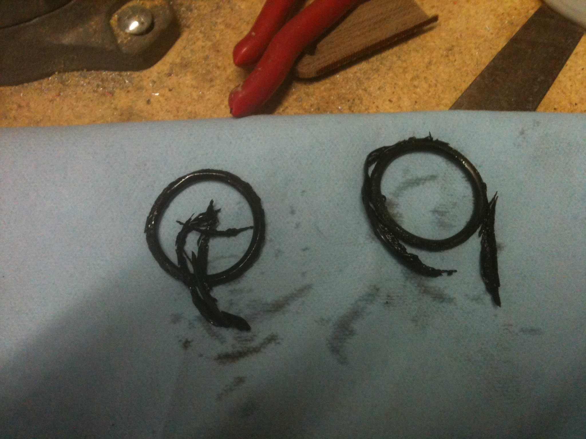

Tracy is correct about automotive brake fluids destroying the stock brake O-rings. Use of DOT 3 or 4 will require replacement of all the O-rings in your master cylinders, parking brake and calipers with items made from EPDM. See
http://en.wikipedia.org/wiki/EPDM_rubber
This material has the added benefit of having a higher temperature rating, when compared to the stock Nitrile [aka Buna N] O-rings. You would also have to change out the flex hoses coming off of the master cylinders from the stock Nitrile lined units to Teflon lined stainless steel items. Use of 3/16" lines will change the feel of the brakes, but not much else. The amount of fluid transfer during braking is small.
I can supply a set of EPDM O-rings if you are interested in swapping to DOT 4. No sense in using the lower rated DOT 3 fluid. For improved heat resistance with the standard fluids, replace the caliper O-rings with items made of Viton rubber.

PostPosted: Sun Sep 01, 2013 10:02 am    Post subject: 3/16 vs 1/4 Brake Lines... Reply with quote
Also note that EDPM is not compatible with 5606 or 83282 ! I thought I
would do the Dot3 or 4 and put in the EDPM ORings but used 5606 later
assuming if good for D3 or D4 it would work as well. See results....not
pretty. Soo...my thought was why change up a good design, just use the
83282 which has a higher flash point and is compatible with anything you are
likely to find at an airport if you ever need a fill away from home. I
think there is also a better O'Ring for the stock 5606/83282 fluid as well.
Bill S
