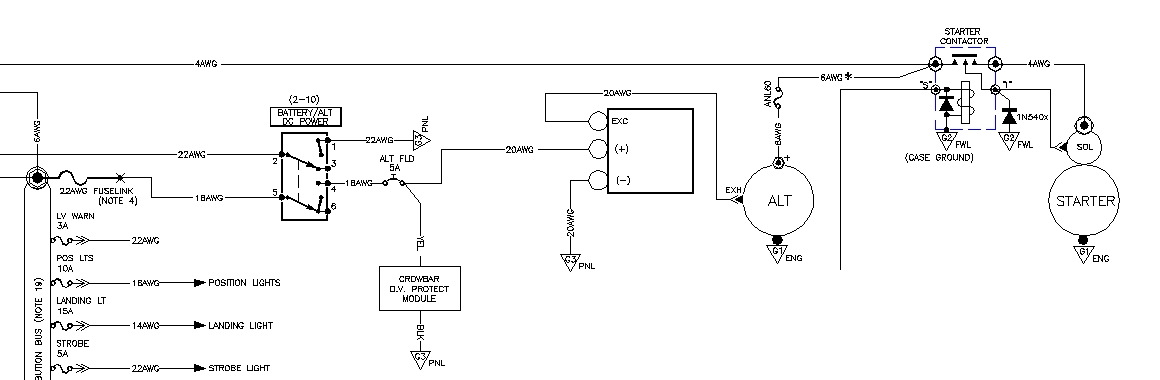

How could I check if my alternator is compatible with en external OVP before wiring it ? (it is not wired anymore)
It was wired like the picture attached in this message. (drawn by constructeur)
Thank you.
Mickaël
The last drawing is the 'magic' data. It shows that
your alternator is externally regulated -AND- that
the alternator control switch does indeed carry field
excitation current. Here's an exemplar application of
the crowbar ov module to your project.

Hello again,
Just to ask a question about this OVP wiring.
I have a filter with it (b&c complet OVP system) for the relay I didn't put it to wire it like the diagram, but the filter have to be add or not in my system ?
What is his fonction ?
Mickaël

At 09:11 AM 6/23/2017, you wrote:
--> AeroElectric-List message posted by: "Achille" <mickael.t(at)live.fr>
Hello again,
The OVP system was configured for use with
a permanent magnet alternator. The filter
is only used with these machines. Your
internally regulated alternator only needs
the OV protection module.
