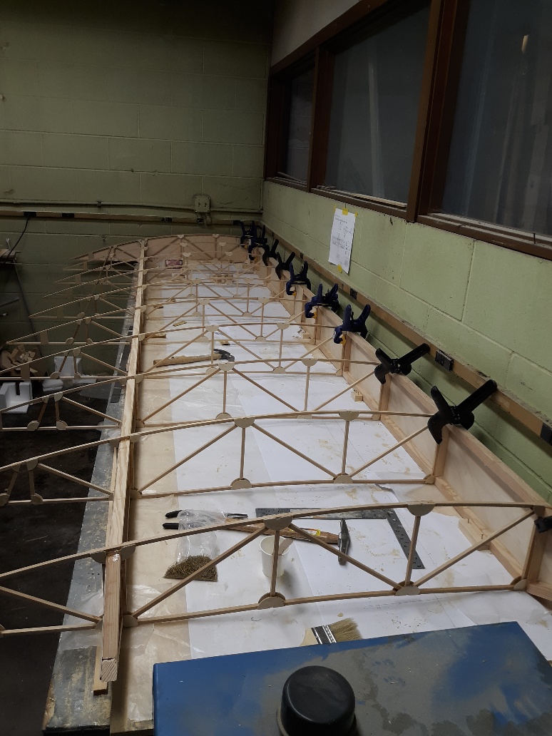

Thanks Kip
I finished the plywood strips on the wing and it is ready for the ailerons to be installed. I cut and installed the plywood on the aileron making progress on it.

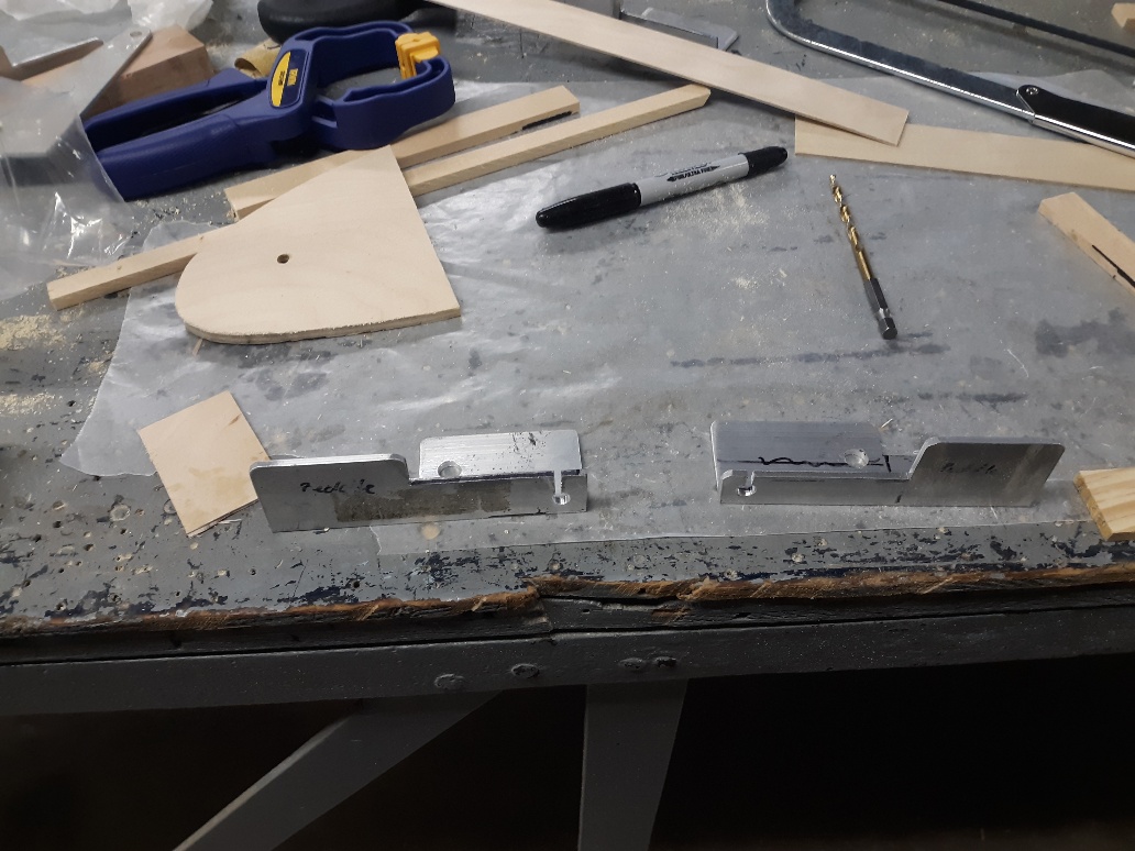

progress is slowing down due to the better weather making so other projects have to be done and allowing for more flying. I have been able to make some progress on the aileron though. the wood is glued to the back of the plywood now ready for the gusset strips

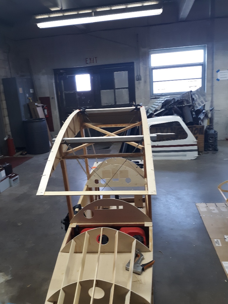

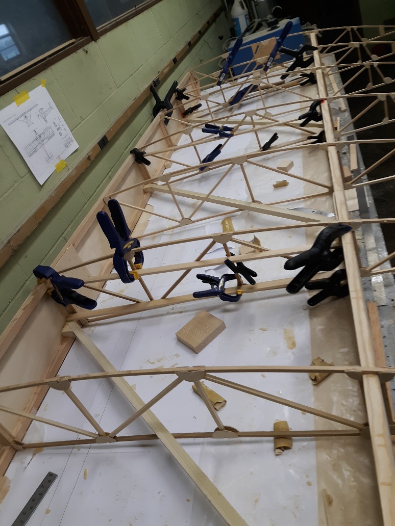

move things around the shop a little today and did some cleaning. the fuselage is out of the little room and in the bigger part of the shop and the wing i am nearly finished on it in the little room the second wing is off the table and in the bigger part of the shop ready for the nose ribs, leading edge plywood, and all the fiddly stuff. I cut out the nose ribs.

I would be interested to know what the uncovered, finished wing weighs. Pick it up and stand on your bathroom scales, then get on the scales and subtract your weight without the wing.

Looking good! Are you going to try to make it a legal ultralight or register it as a certificated aircraft? Once I get started on mine, I’m planning on registering it as a certificated LSA, in part because my life insurance has a specific exclusion for dying in an Ultralight accident, Lol.

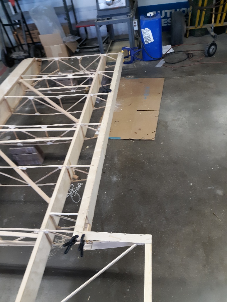

the rain gave me some time to work in the shop today. I got the nose ribs glued on and the leading edge plywood for the center section measured and cut. It is now clamped and strapped to the leading edge to form before being varnished and glued in place.

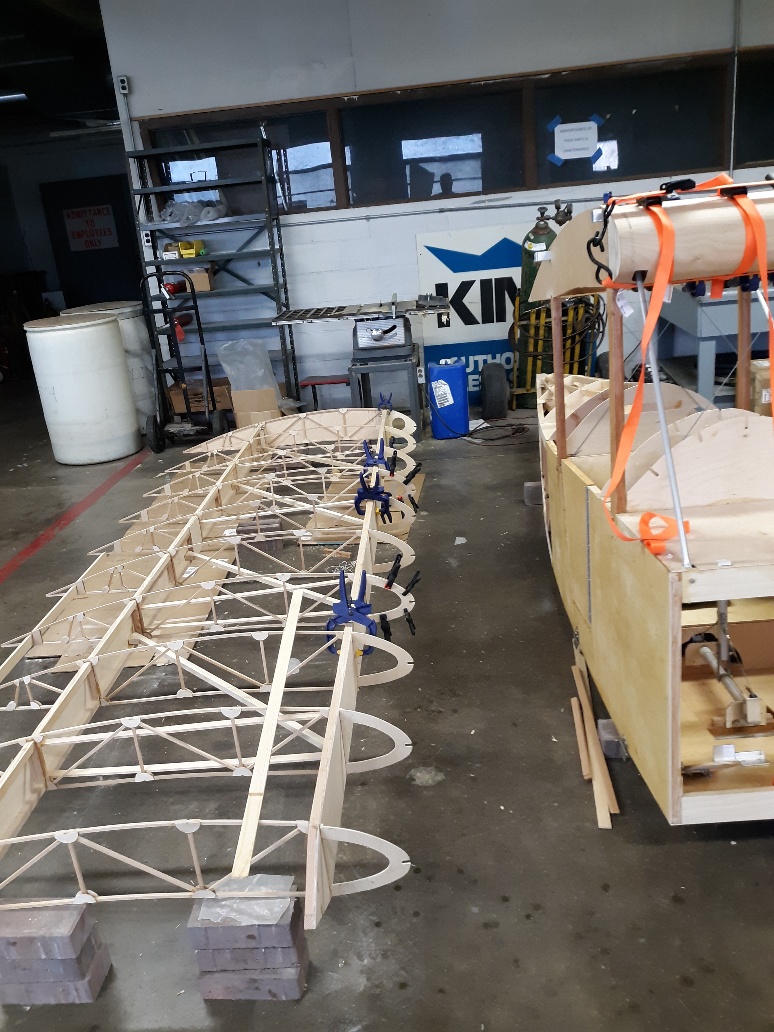

the leading edge and aileron spare are glued in place now, as well as the wingtip dowel.

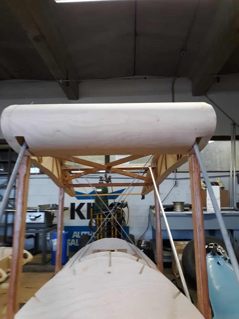

All I know is, those landing gear legs with the light blue fairings look WAYYY too big for your Ultra-Piet!

I don't know they might look good with a set of spoked wheels on them

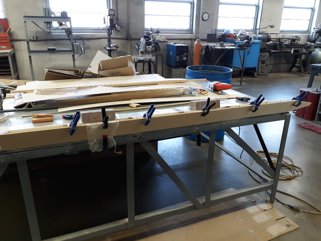

got some T-88 mixed up over lunch and glued the leading edge plywood to the center section.
