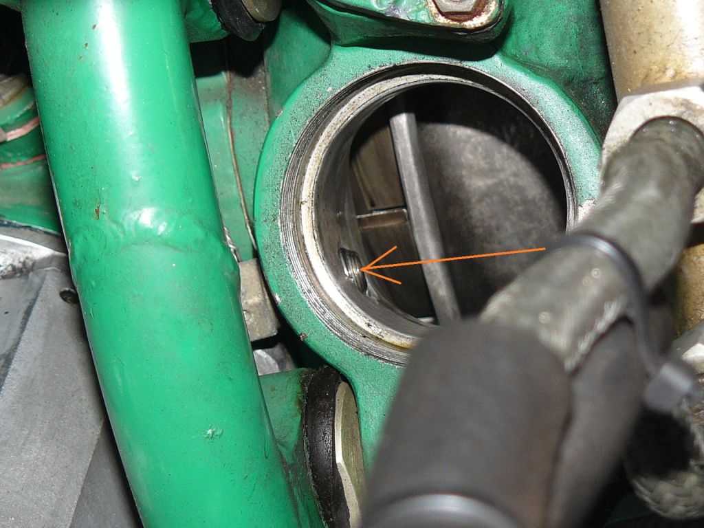

Vic
Joined: 12 Aug 2008
Posts: 117
Location: Southern Bavaria
PostPosted: Thu Oct 28, 2021 6:34 am    Post subject: Re: Still will not start Reply with quote
Did you check the primer jet for a reasonable spray forming, a poor running down of fuel from there is not great for starting ?
As to no suction on carb, my guess the blower drive may be defective. Take out one intake elbow and look inside for checking the blower rotation, maybe with endoscope, I am not sure one can see it without one - anybody ?
Vic
