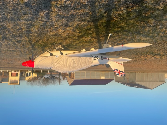

Feeling brave I put on my drysuit & headed to France for a couple of days.
Took a while to de-ice before departure but the ignitech modules worked really well using battery energised ignition.
I plan to fit the Ecclestone carb heat manifold (https://ecclestonaviation.co.uk/product-category/carb-heats/?v=79cba1185463) & seek advice for best design of drip tray to use.
I have the curved Rotax drip trays & they will not fit when the carbs move aft.
Did someone cut and extend the curved drip tray?
[img]cid:DC4F7580-EF98-4CF7-8106-1EC760E85D21[/img]

Hi Roger,Brave man in the middle of winter!
I have the Skydrive Carburettor heat manifolds fitted which look very similar.
Yes, if I remember correctly, it is a tight fit for the Rotax drip trays and I did have to get them extended to cover the carburettor bottom. Good aluminium welder did the job.
Had to alter the tray edges also to avoid exhaust pipes and through age had to repair some cracks later on.
