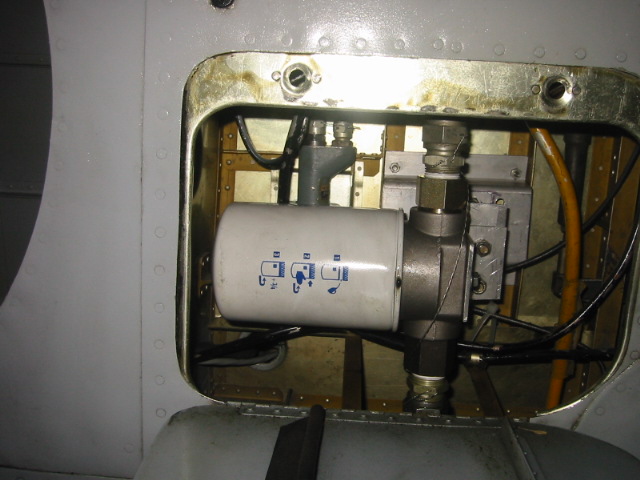

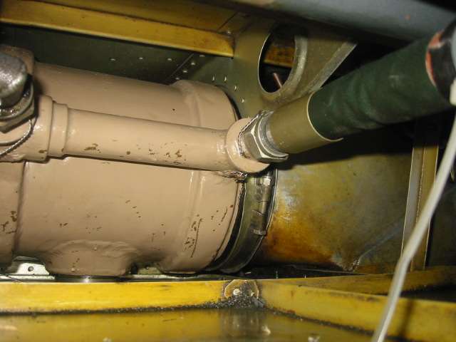

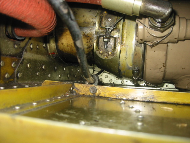

PostPosted: Mon Dec 11, 2006 6:41 am    Post subject: Recommendations for oil filter system Reply with quote
Dennis
I used a 10 micron filter plumbed into the oil line that is just prior to entering into the oil cooler. 50 hours on it and absolutely no problems. The location is clean and easy. No lines to cut into, and only one line to form. It keeps the clutter away from the engine. Changing the filter does not spill onto the airframe. Since you don't have to cut any lines, you have the option of going back to the original configuration in the field if you need to. See attached for location and fit. The filter is for high performance autos. If you are interested, I'd have to check my notes on where it came from.
Jim B.

 Filesize:  90.35 KB
 Viewed:  394 Time(s)
 Filesize:  90.56 KB
 Viewed:  361 Time(s)
 Filesize:  105.37 KB
 Viewed:  385 Time(s)
