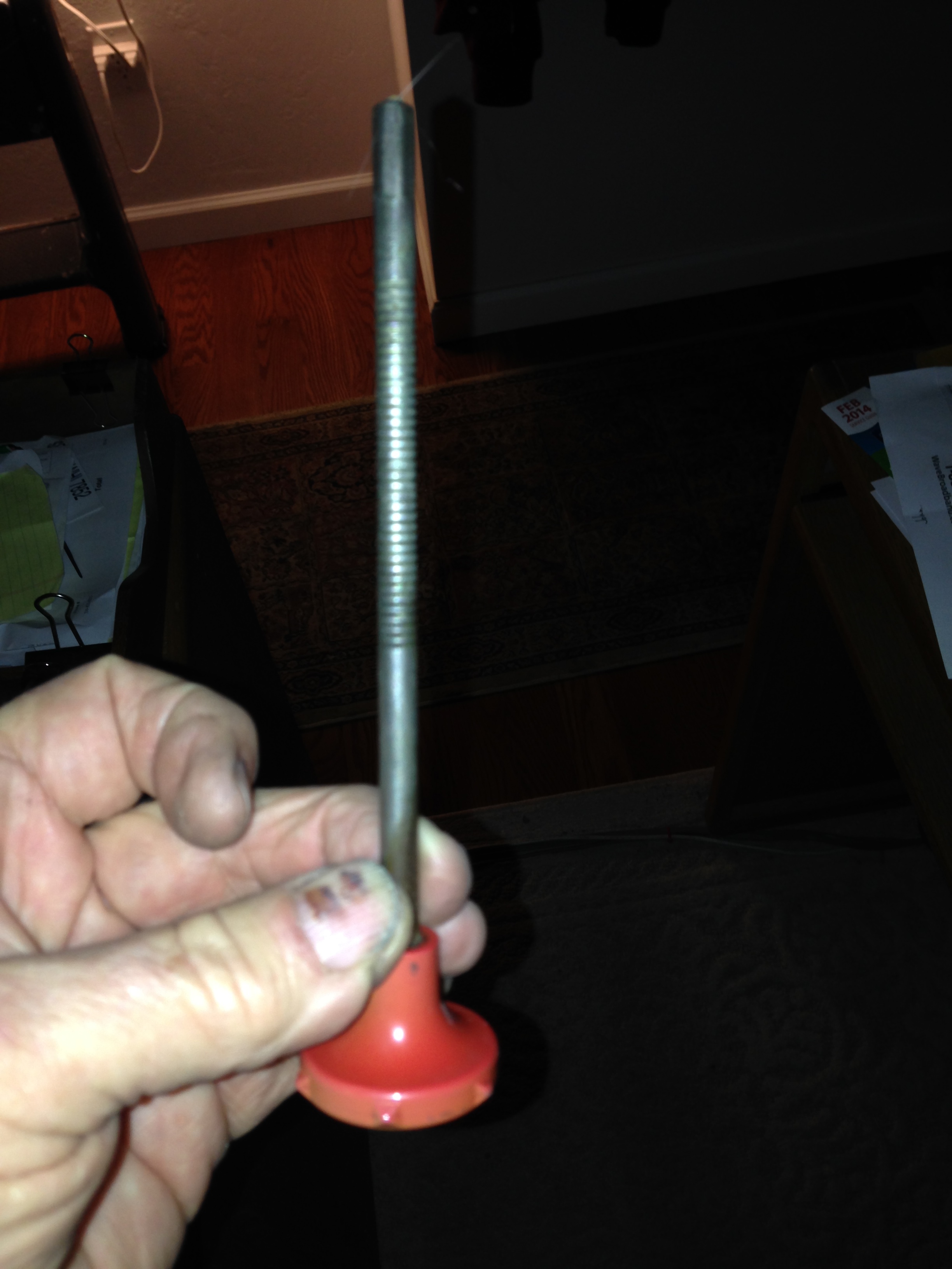

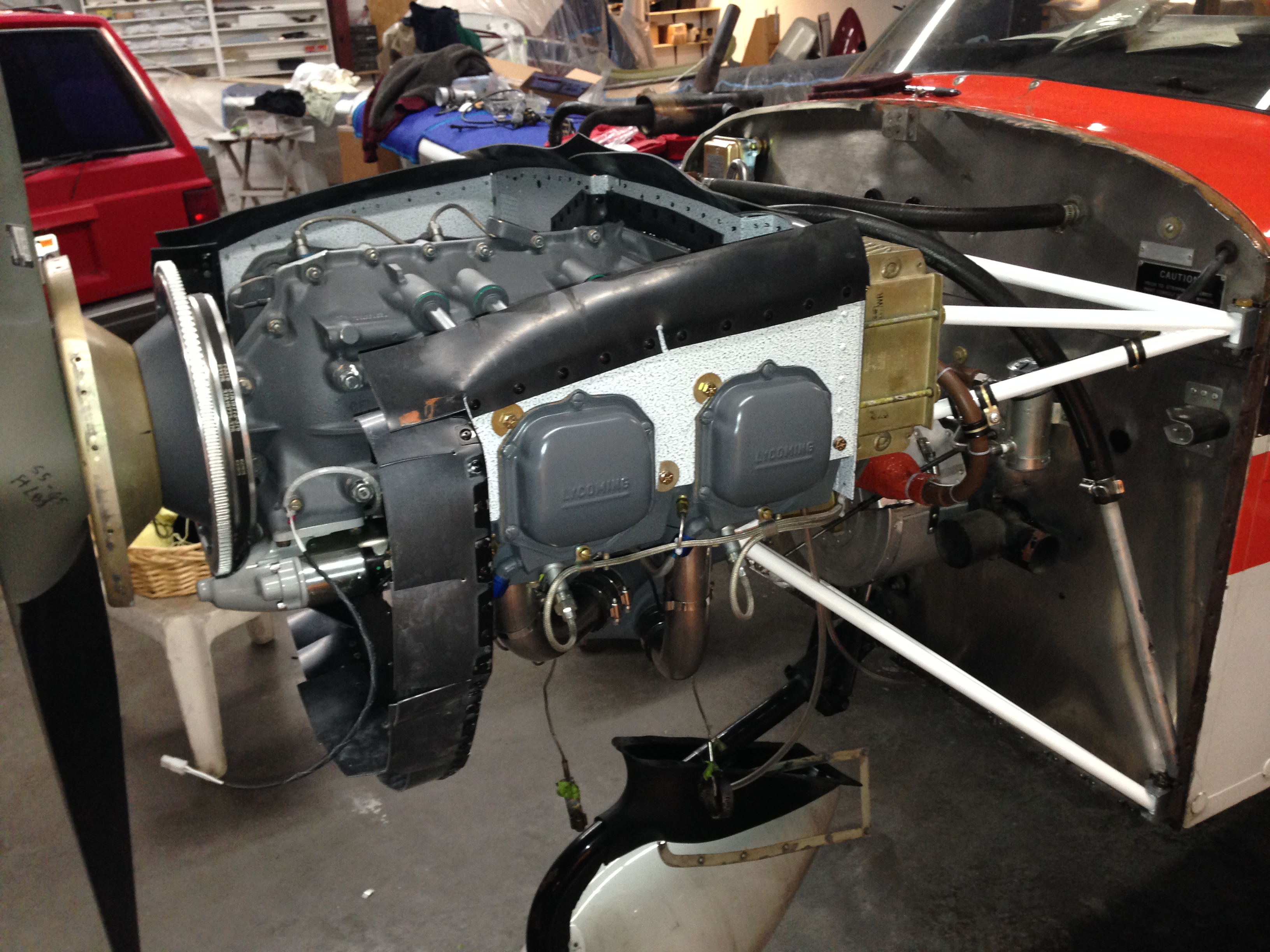

I had just finished setting the mixture on a FWF restoration I'm doing on N28819. You can see a lot of pics of it on the AuCountry Aviation Facebook page.
When I pulled out the mixture to check one last time to make sure the mixture went to cutoff, the cable broke. That has never happened before.

Not good. How often should these be replaced?

That happened to me once. Fortunately, it happened at the end of a flight with the last pull of the mixture cable to kill the engine. It just kept coming out. Glad it didn't happen during flight....
I did have a throttle cable disconnect during another flight. Glad the mixture didn't break that day....

This is the first cable failure I've seen. I've seen problems with the throttle brackets on the AG5B but nothing on an AA5B.

Looks just like the mixture cable failure on the AA-1/A/B that has the 500 hour replacement.
Haven't seen it on a 4-place, but have seen and replaced several on 2-place.
Beech had a problem with them on the Skipper, too.

75-09-07 04/25/1975 Mixture Control Wires
Affects all AA-1, AA-1A, and AA-1B. AA-1C were exempt, because Grumman claimed they "re-routed" the mixture cable.

Apparently that was not the lifetime warranty cable.  From the looks of the faded knob, I may have been in there for lets say, 36 years?

I saw this happen to a prop cable. Came right out while the pilot was cycling the prop before takeoff. It was a vernier cable, and
the pilots flying that plane had a habit of screwing it in before landing, rather than pushing it in. They'd screw it all the way
in and then some, kinking the cable.
On the AA-1 series, the recurring AD can be eliminated by replacing the cable with a vernier control. Oh, well ...

Screwing the cable in, or Pushing the cable in makes no difference.  If anything, pushing it in would put more flexing force than screwing it in.  The 'CABLE' does not turn when being screwed in, it is only shaft portion right behind the the knob that turns; Full In is Full In.  No matter how it is achieved. There is also a 'slippage' to the screwing action, so you could twist all day long without ever increasing any force on the cable.  Why did the cable break?  Only the cable knows for sure.

The same thing happened to me at the end of a flight in my AA1C. My A&P (new to me at the time) said there was an AD on it but that was secondary, the mixture control obviously had to be replaced since it was broken, AD or not so I didn't research the point. At the time the plane had in the vicinity of 1000hrs TT ±. So I think the rumors of an improved bracket on 1C models negating the AD might be overstated. The AD (from the above link) was published and amended in 1975 which was two years before the C model came to market. Maybe the cable really was improved so was never added to the AD, I'm not going to research it now, but quite obviously based on my experience the cable was still susceptible to breakage after very low time in service. Even on an AA1C. I put a vernier mixture control on the Lynx and never had another problem in the next 10 years until I sold it.

I guess that is why the AD on the cables. Why hasn't the AD covered the
AA5x series?
Better on the ground that in the air and consider how difficult the FAA
would have made your life if there was an accident!
Barry
On Tuesday, February 18, 2014, Gary L Vogt<teamgrumman(at)yahoo.com> (teamgrumman(at)yahoo.com) wrote:
page.
Brent Smith

A vernier mixture cable is the way to go. The cable is much thicker, and is an alternate means of compliance on the AA-1 500 hour replacement AD. I like the fine tuning adjustment it provides, and on shutdown, I screw it out till the engine quits and watch for the tach rise.

You said something that is very interesting to me: "The cable is much thicker, and is an alternate means of compliance on the AA-1 500 hour replacement AD." I have used other sources as proving that the ALCOR cable is approved for the replacement- Have you found the statement AMOC (Other Means Of Compliance) for the cable? It would make writing up the 337 a lot easier and easier to prove.

The Alcor cable is PMA for all the Grumman singles (plus all other carburetor equipped singles), so no 337 is required.
The 500 hour replacement requirement of the AD is part number specific, so not applicable to the Alcor cable.
Had the AD said "replace mixture cable every 500 hours", then it would not matter what cable was installed.
