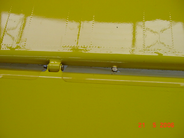

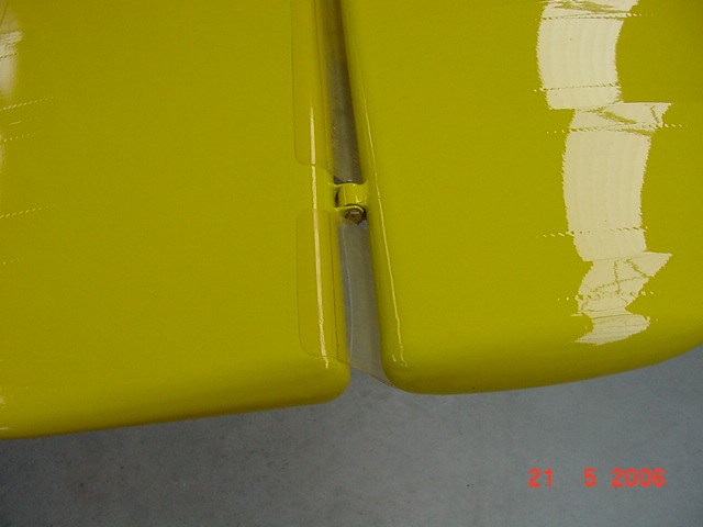

I think we had a similar discussion a while back. Try closing the gaps on
the elevator with clear tape, as seen on the Sportflight pics. While I can't
confirm a huge change on mine, others swear by it for getting elevator
effectiveness. I noticed an improvement, but nothing radical.

I find that gap seals make quite a improvement.
From: "Bradley M Webb" <bmwebb(at)cox.net>
Reply-To: kitfox-list(at)matronics.com
To: <kitfox-list(at)matronics.com>
Subject: RE: small file Blank series V weight and balance
Date: Sat, 12 Aug 2006 08:22:03 -0400
--> Kitfox-List message posted by: "Bradley M Webb" <bmwebb(at)cox.net>
Also, a forward CG is a classic scenario of running out of elevator at low
speeds (in the flare). As the CG moves aft, the elevator gets move
authority, but it also gets more sensitive to small inputs at higher speeds.
Eventually it will get uncontrollable. Forward is better than aft, but you'd
be relegated to wheel landings.
Airplanes have loading limits, i.e., limited fuel with two passengers, etc.
You might want to check your W&B and see how different loadings affect you.
If you've not looked at it that way, you might be surprised.
My 2 runs out of elevator really quick with flap landings, but the gap seals
helped a little. Going from memory, a test I read showed that even a small
gap in a control surface reduces control effectiveness by as much as 30%. Hi
pressure always seeks low pressure, and it flows very nicely through that
gap. Thereby that air leak is not working for you.
Bradley

Posted: Mon Aug 14, 2006 8:42 pm Post subject: small file Blank series V weight and balance |
Thanks John for the pics of the gap seals,this is the way I need to go.......Did you get this from spruce?
Thanks Mark
