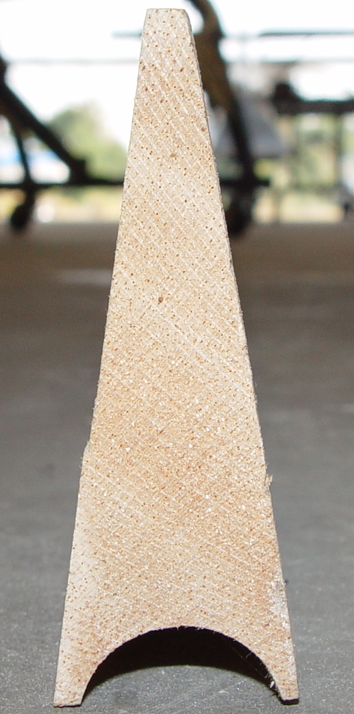

PostPosted: Thu Sep 13, 2007 11:38 am    Post subject: Strut fairing questions. Reply with quote
Regarding lift strut fairings...
Some of you will remember the original wood style fairings.. The install was
fairly simple and very easy to work with even after the aircraft is flying.
The PVC Fairings were introduced and while they offered a more true airfoil
shape they also added significant weight. They are also very time consuming
to install nicely as they have a 2 ridges on each side of them that should
be sanded down. The aluminum cuff on the end also created some challenges.
That being said we have chosen to look back and re-introduce the wood...
although a little different. We have chosen Balsa as the medium to use for
several reasons.. believe it or not strength is one, ease of install and
sanding, and the other is weight. The 2 lift struts weighed in at almost
14 lbs difference from the PVC to the Balsa and the Balsa is stronger.
Speed differences between the 2 is negligible. The new Balsa fairings
maintain the correct proportions to the diameter of the tube. We have seen
and had reported from 8 to 14 mph difference with either style.
The Strut fairings will also include the horizontal lift strut pieces as
well for the single horizontal support tubes.
We have not introduced these officially yet as we need to develop the
installation instructions for them.. However, they are ordered and should be
in stock hopefully by months end.
Installation is pretty straight forward. Bond, shape, seal, cover &
paint... Smile
Fly Safe !!

John,
How close in the balsa compared to the old pine/fir ones used previously?
It looks like it might have a slightly longer chord?
Thanks, Paul

Paul,
They are a longer chord... There is an aerodynamic rule of thumb for
streamline shapes and we have tried to stay close to that.
Fly Safe !!
