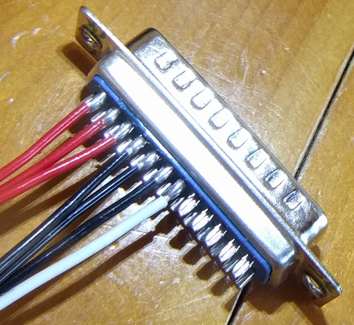

One more photo. I disassembled and reassembled the first connector that I did (more than a week ago). I am much happier with this iteration:
[img]cid:.0[/img]
These wires are for the pitot tube heater. It draws 12 amps so I am using three pins each for power, plus one pin for the status lamp. These three 20 AWG pigtails join to 12 AWG wire which runs the length of the wing.
  These joints look good. I would use 22AWG "ballast
  resistor" pigtails. Here you are actually using
  the wire as a resistor . . . the larger the better
  from the standpoint of sharing loads across an
  array of pins. Also, be aware that the legacy
  heated pitot tubes have a strong temperature
  coefficient. A typical pitot heater for a Beechejt
  is 1.5 ohms at 0C . . . a time when the tube is
  likely to be turned on. 28V/1.5 ohms is 18A start
  up current. When the heater gets to 100C (typical
  high altitude condition) it goes to 2.2 ohms
  for 12.7A running current. 14v probes behave similarly
  at about 2x the current.
  What kind of probe are we talking about?
  If you've lots of unused pins in this connector,
  it wouldn't hurt to use 5 or 6 pins per path
  and I'd certainly drop to 22AWG ballast wires.
  Another thing to consider for the solder-cup
  connector is the form of the female pins in
  the connector . . . not quite as robust and
  uniform their crimp style cousins . . . so
  extra pins if available wouldn't hurt a thing.
  The work we did at Beech was entirely with
  crimped pins. I'm not suggesting that your
  design goals cannot be met with this connector,
  just that I have no experience with the parallel
  pins in the commercial connectors so if there
  are unused pins in the connector, bringing
  them into harness with the three already in
  service is not a bad thing to consider.
  The extra wire is a 'sense' wire? What does
  it do for you?
Bob,
I'm glad that those connections look better. The other ones that you criticized were my first two. I'll go back and rework them.
I am planning a Dynon heated pitot tube. Here is my wiring diagram, including the warning lamp:
 pitot.pdf
​Dynon says that that lamp will illuminate if the heater fails.
I have plenty of spare pins in the connector. See my connector "diagram"
 wing root connectors.pdf
Dynon says 11-12 A for the heater so I planned on 3 pins (at) 5 A per pin.
I'll have to buy some more 22 AWG wire if I am going to switch the ballast wires. Do you see any reason why I cannot buy 22 AWG wire locally (which won't be tefzel insulated) instead of mail ordering a small amount of tefzel wire? I can't think of any reason to prefer one insulation material over another for this application.
Cheers,
    -- Art Z.

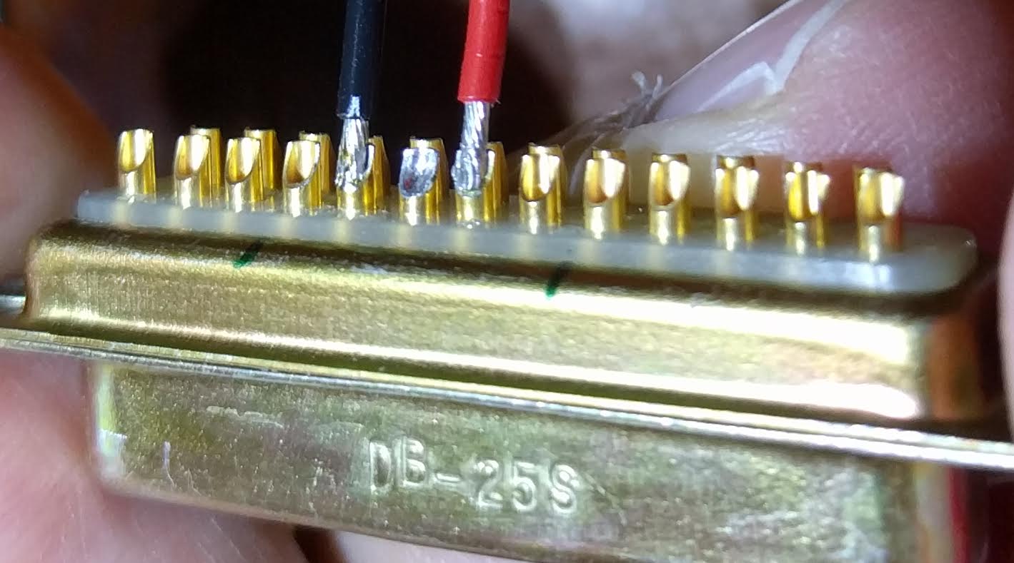

I am trying to solder 20 gauge wire into DB-25 connectors and having a tough time. The conductors just barely fit into the cups on the backs of the pins when everything is "dry," before tinning. After I tin either one, pin or wire, I cannot get all of the conductors into the cup. I end up with something like this:
[img]cid:ii_itdlrj9b0_1574f4d7e91899df[/img]
I'm afraid that those are not acceptable. What do you think?
If they are not acceptable, what is the solution? Can I trim a few conductors away so that the remainder will slip into the cup? Or should I just give up and switch to crimp pins? Or what?
