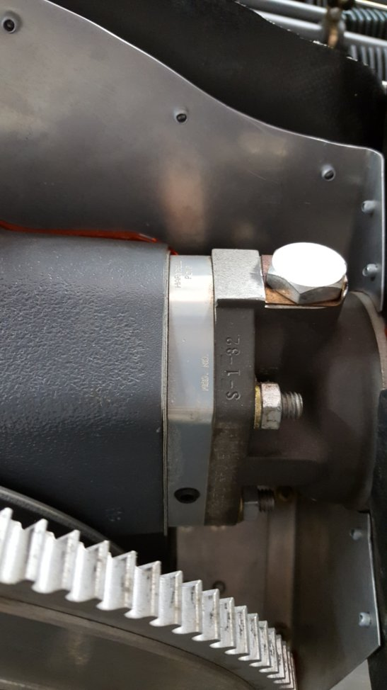

Thanks everyone for the suggestions.  All of you were correct, it came down to RPM.  Alex DeDominicis dropped by earlier as I was outside trying to get things to work.  I told him the situation and ran it up with him outside. He said there was no way the engine was running at 2000 RPM, so he proceeded to jump in and pushed the throttle up beyond were I had gone yet.  At around 3800 RPM... The prop finally engaged.  After nearly having a heart attack, he said that was closer to 1900 to 2000 RPM.  So it seems my Dynon EMS is doubling the RPM for some reason, need to do some more research.
Prop problem solved, on to the next one!
Thanks for the input, you guys nailed it.
Vernon
On Sat, Apr 22, 2017 at 8:55 PM, Vernon Franklin <vernon.franklin(at)gmail.com (vernon.franklin(at)gmail.com)> wrote:
I started the engine for the first time today Smile
Everything was in the green, and looked really good.  But when I went to test the prop, it would not cycle.
I have a hartzell gov, and the arm swing is good.  Everything from the outside looks like it should work.  Everything is stock from Van's FWF or Lycoming.
I definitely pulled the plug on the crank case, that isn't the issue.  I just don't know the first place to start looking.
The only thing I can see from the outside, is this spacer between the governor and the engine, maybe the teeth on the gear cannot reach far enough.  See picture.
[img]cid:ii_15b9881cd1bbd634[/img]
Anyone ever experience this?

If you go into settings, then to calibration (bottom option on the main settings list), then to EMS Calibration, then to RPM, change the pulses per revolution. Depending on your ignition system, there will be different pulses per revolution. If it's reading double, then double your pulses per revolution and that should fix it. Easy peasy.
Vernon

With Dynon it is usually a wire to the p-lead with a resistor.

Agreed. The Dynon default is 1 for four cylinder engines. You need 1.5
for six cylinder. Not sure why you would be getting double actual if you
had the default 4 cyl setting. Make sure you have the approx 30K
resistor in the line between EMS and P-lead. Can need higher if there
are some spikes seen.

Not having studied the Dynon manuals, my guess would be that two pick-ups (one on each P-lead) are combining to double the reading.

I was thinking the same thing. If the setting is 1 and needs to be 1.5, then 2,000 rpm would read as 3,000. If it was set at .5, then it would be triple instead of double. Either way, it should be made correct by adjusting the pulses per revolution.
Also, in my instructions, I was assuming it was Skyview. The D120/D180/D10 would be different.
Give me a call tomorrow or the next time you are at he plane and I can walk you through the setup.

Make sure you have the 30k ohm resistor inline on both the white/green and white/blue wires close to where they tie to the p-lead, then follow this (6-cyl should be either 1.5 or 3.0 based on this):
Increment or decrement the PULS/REV R and L values to correspond to the number of pulses put out by your tachometer source for each engine revolution. You may select the pulses/rev for both the left and right tachometer inputs independently. If they are both p-lead inputs, these will likely be the same number. However, if you have connected two different types of tachometer sources, you will likely have to input different values into these fields. If you are using a p-lead connection, the PULS/REV value will typically be set to 1⁄2 or 1⁄4 of the number of cylinders in the engine. If you find that the onscreen tachometer reads double or half what you expect, adjust the PULS/REV value until you observe the expected value. If you do not have anything hooked to one of the tachometer inputs, the PULS/REV setting for this input can be set to any value. The FlightDEK-D180 will automatically ignore this unused input
