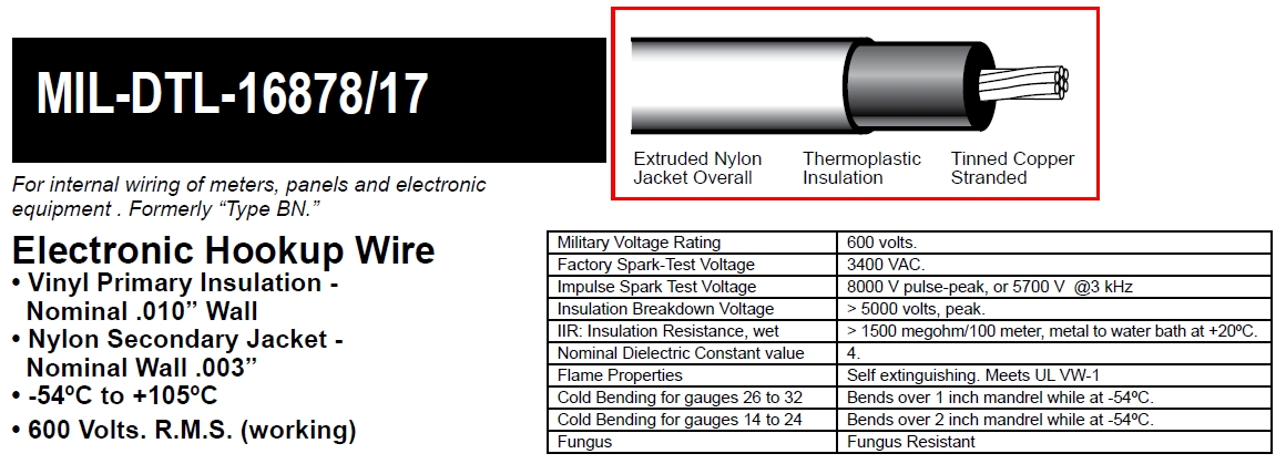

Barry,
A randomly selected list for your perusal:
http://www.nationalwire.com/pdf/cat01_elect_hookup_wire.pdf
On the subject of Very Caustic Fumes: Close yourself up in a closet & burn some Tefzel insulation. Report back (if able).
[img]cid:7.1.0.9.0.20180428231328.070c6da0(at)aeroelectric.com.0[/img]
Yup, that's the stuff!
