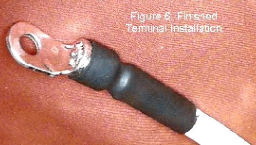

At 08:56 AM 5/11/2018, you wrote:
Bob:
You are mixing Apples and Apple Sauce and coming up with Lumpy Apple Sauce.
Those are PINS not Lugs.
okay . . .
The Pins are supported by the connector.
yes . . .
The Lugs are hanging out into the air. No support!
that's what double wall heat shrink is for . . .
And that is why PIDG type Lugs are preferred!
preferred but not necessarily required . . .
especially when using 'softer' fat wires
for battery/starter circuits.
[img]cid:7.1.0.9.0.20180511112547.0595a938(at)aeroelectric.com.2[/img]
