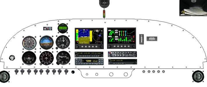

In light of this discussion I am attaching my current panel configuration for informational purposes. Its probably going to still change quiet a bit but the layout is probably close. I think the location of the instuments allows the pilot to use either a standard 6 pack or the EFIS tubes. I actually prefer a standard 6 pack in a lot of situations but want the HITS capability of the EFIS. The airplane will have a vacuum system and an EFIS.
Niko

Not bad, Niko, but I think you'll actually come to like the EFIS
better than the 6-pack for the references you can get. If it
were me, I'd flip them so the 6 pack is either low or to the right,
and center up your EFIS on your side of the plane so it's right
in front of you. I know you're trying to recreate a total
steam gauge set, but given what you have in the EFIS, I'd use
that more, and ditch the VSI and Turn Coordinator completely.
Even if all heck breaks loose, you can get by without those
2, although admittedly they do have useful purposes...but
if the steam gauges are your "backup", then it's not worth
duplicating those functions. On the other hand, if the EFIS
is your "backup", and you're adamant about that, then I'd
say you should ditch one of the screens, or just use it as
a full-screen map page.
Actually, the best thing for you since it looks like you're
on the fence about trusting that you'll like an EFIS, is
to get out and get in someone's plane with a GRT system
and fly behind it. You may be put at ease knowing that it
actually works pretty well. From a steam gauge replacement
point of view, today's EFIS's really do a great job at
taking over for a 6-pack. From an approach/terrain/weather
and more extended EFIS/MFD function point of view, then you
have to decide if the more expensive EFIS's are what you
need or not. The GRT stuff though is great in that it gives
you a lot for a little.

[quote] In light of this discussion I am attaching my current panel
