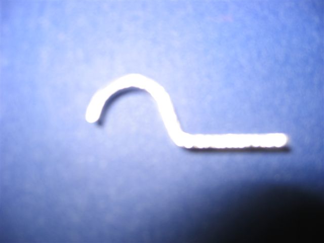

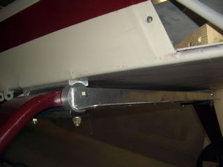

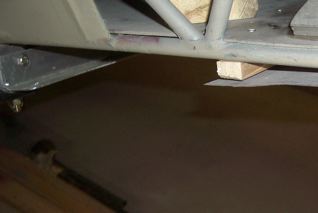

A friend is building a series 5 and so am I. His kit came with an aluminum extrusion to use to cut out clips to attach the aluminum pan under the rudder pedals. He had me cut them for him and here is a picture of the extra one. This is the second plane that I have seen use them. They get epoxied to the tubes, then either a rivet or screw holds the aluminum pan.
Jim Z

Jim, Thanks for the picture. I will fabricate some of those clips. What brand epoxy do you recommend? Pat Reilly Mod 3 Rebuild Rockford, iL

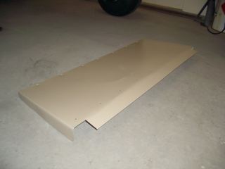

PostPosted: Sun Jan 20, 2008 6:05 pm    Post subject: aluminum Belly Pan Reply with quote
On 20-Jan-08, at 8:31 AM, Lynn Matteson wrote:
I have a Grove gear, and it seems like there must be a bit of drag on
that, where the air passes between the belly of the plane and the
gear. I have thought of putting a belly pan in that area, using the
screws that hold the bottom portion of the firewall...the horizontal
"flap"...to hold the front of the belly pan. My notion was to remove
the screws, slide the front of the belly pan under the firewall flap,
and screw it back down. then slope the belly pan down under the Grove
gear, and then back up to the fuse. I'd make the whole thing about 2
feet long, and this would streamline, to some extent, the Grove gear.
I haven't worked it all out in my mind yet, but the sides could be
formed up, I'm thinking, to cover the gear attaching brackets, and
fair those in as well. The biggest problem as I see it would be
attaching the rear of the pan to the fuse. Maybe some brackets
epoxied inside the fuse to the crosstubes would work. A belly pan in
this area would ease cleanup in this area as well.
A fellow lister has a Model V, and the builder of that plane actually
did some structural work in that area...Grove gear...to fair in the
belly of the plane, and enclose the gear at that point. Danny, Deke,
or Duane might want to shed some light on this, Danny especially.
Lynn
Just happens that I had the same thought as you that the Grove gear
area would create an area of  extra drag between the gear and the
belly.   I just finished fabricating a small belly pan which will be
attached at the front under the firewall flap using screws into a 1/2
x 3/4 wood cross brace which is in turn held to the fuse by screws
through the floorboards.  (i.e.  no holes in tubing.)
At the rear I have drilled and tapped a couple of holes into the
round aluminum gear retainers and then attached an aluminum angle
across the width of the fuselage.  The bottom of the angle is flush
with the bottom of the Grove gear.
A couple of small photos attached.
Jim Corner
Model 2, 582,. Ivo med !FA, 1100 hrs
Model 5 under construction
Calgary, AB
