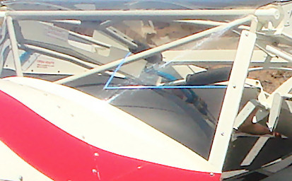

9. Make sure you have memorized the field of reference out the wind screen, such that the plane is flying perfectly straight ahead !! There is definitely a technique for this as the off centered view in a fox is deceiving.
I still have my "beginners" stripes on my windshield. 1/8" blue tape. The horizontal one is the horizon in a 3-point attitude. The vertical one is a "gunsight" that doubles when I focus at infinity, giving me a bracket for the centerline. Embarrassing, but I've gotten over it.
