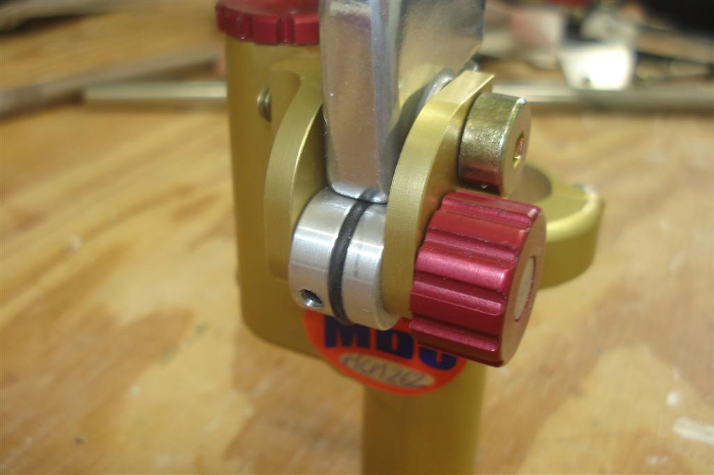

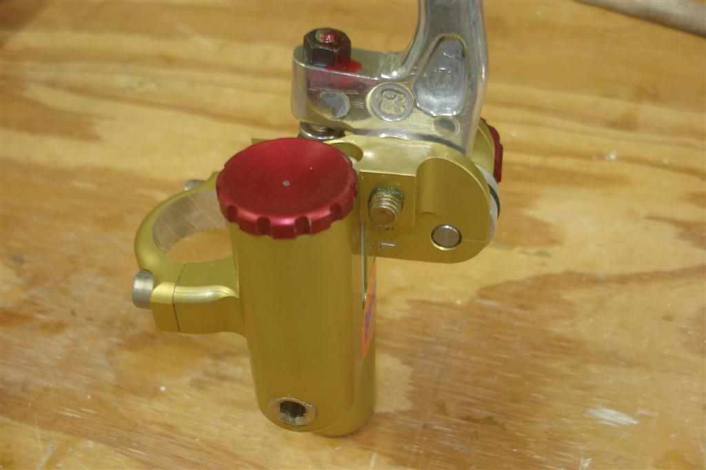

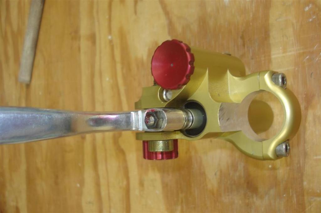

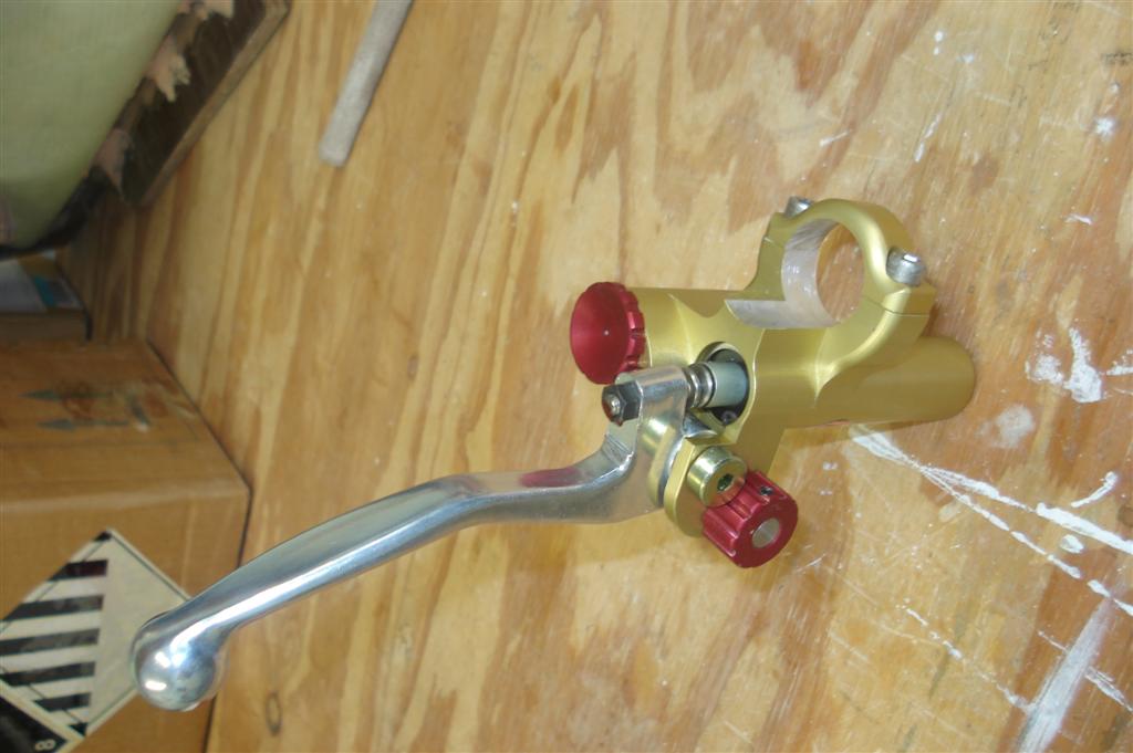

PostPosted: Sat Oct 17, 2009 12:14 am    Post subject: Monowheel master cylinder? Reply with quote
Fellow Mono builders/operators,
Why would you stuff around trying to put a reservoir on the Europa supplied
Master Cylinder (355 gms WITHOUT reservoir or hand brake feature) when you
can spend a fortune and have the attached. (270 gms WITH reservoir and hand
brake feature). Not only that, it fits on the stick and lets you do
something else with your third hand that is needed with the standard Master
Cylinder as supplied.
Cheers
Kingsley

hurstkr(at)redzone.com.au
PostPosted: Sat Oct 17, 2009 3:40 am    Post subject: Monowheel master cylinder? Reply with quote
Kingsley - which is available from ......?
G'day Rowland,
http://mcylulm.free.fr/doc/pdf/maitre_cyl_a_main.pdf
Mike Parkin advised us about this little gem on the list back in June this year so I'm not claiming credit for the discovery.
Please note that the email address on the website is incorrect (has a missing "t"). It should be MDOaircraft(at)aol.com (MDOaircraft(at)aol.com)
Also, the cost of the Master Cylinder only is 232 Euro, not what it says on the website. Fittings and S.S. braided hose are extras.
Just got mine this last week and it certainly is a nicely made unit.
A prospective purchaser will need to advise:-
  • the Stick Diameter 25mm or 25.4mm i.e. 1 inch. If 1 inch, the fitting is reamed out to suit
  • if you wish to use red Aeroshell 5606 fluid or plain automobile DOT4 fluid. Needed to install the proper seals.
Hope this helps
Best regards
Kingsley
G'day Rowland,
Hope this helps
Best regards
Kingsley

rlborger(at)mac.com
PostPosted: Sat Oct 17, 2009 3:59 pm    Post subject: Monowheel master cylinder? Reply with quote
Mike,
Thanks for pointing us to MDO Aircraft and M. Bastein.
Denis says that it will be at least two weeks to fill the order as he is waiting for a shipment of
springs. Waiting on parts. I can relate to that.

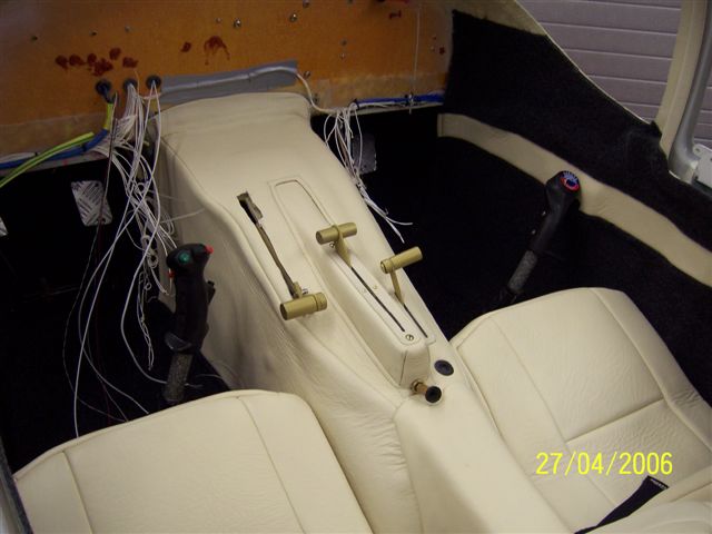

PostPosted: Thu Oct 29, 2009 5:21 am    Post subject: Monowheel master cylinder? Reply with quote
Bob,
I am going to the permanently installed refilling bottle. That will be semiplastic, semitransparent and equipped with an easily openable cap. The bottle will be aesthetical and the crown of RT`s cockpit, do not worry. I have also checked it will not prevent the normal use of the brake lever.
The breathing hole is NOT necessary because because it is not an ordinary reservoir.
The tube between the bottle and the cylinder will/must have an OFF-ON valve.
Normally the valve will be always OFF.
I will open it only when the system must be filled or refilled.
That means no changes to the POH.
How to fill (worn pads or very cold):
1) open the cap of the bottle.
2) open the valve.
3) gently make some peaceful strokes by lever
4) close the valve
5) close the cap.
How to refill (when new pads or very hot):
1) as fore
2) as fore
3) gently push some amount the lever and keep it there (there must be space for extra fluid in the bottle!)
4) as fore
5) as fore
6) relax the lever
All this will be one minute task and no mesh and always ideal brakes.
Changing the whole cylinder is not a realistic option for me!
I definetely do not want to spoil and make a new leather upholstery when removing an old cylinder an installing new one. If I were still in the building phase I would absolutely go for it.
I would love to have also a parking pressure valve! Now I have only a mechanical one (a triangle shape alu sheet with a lanyard connected by a miniatyre pip-pin) but I am happy with it and it makes passenger(s) relaxing because it is so...funny.
Raimo OH-XRT
 Filesize:  43.8 KB
 Viewed:  4613 Time(s)
