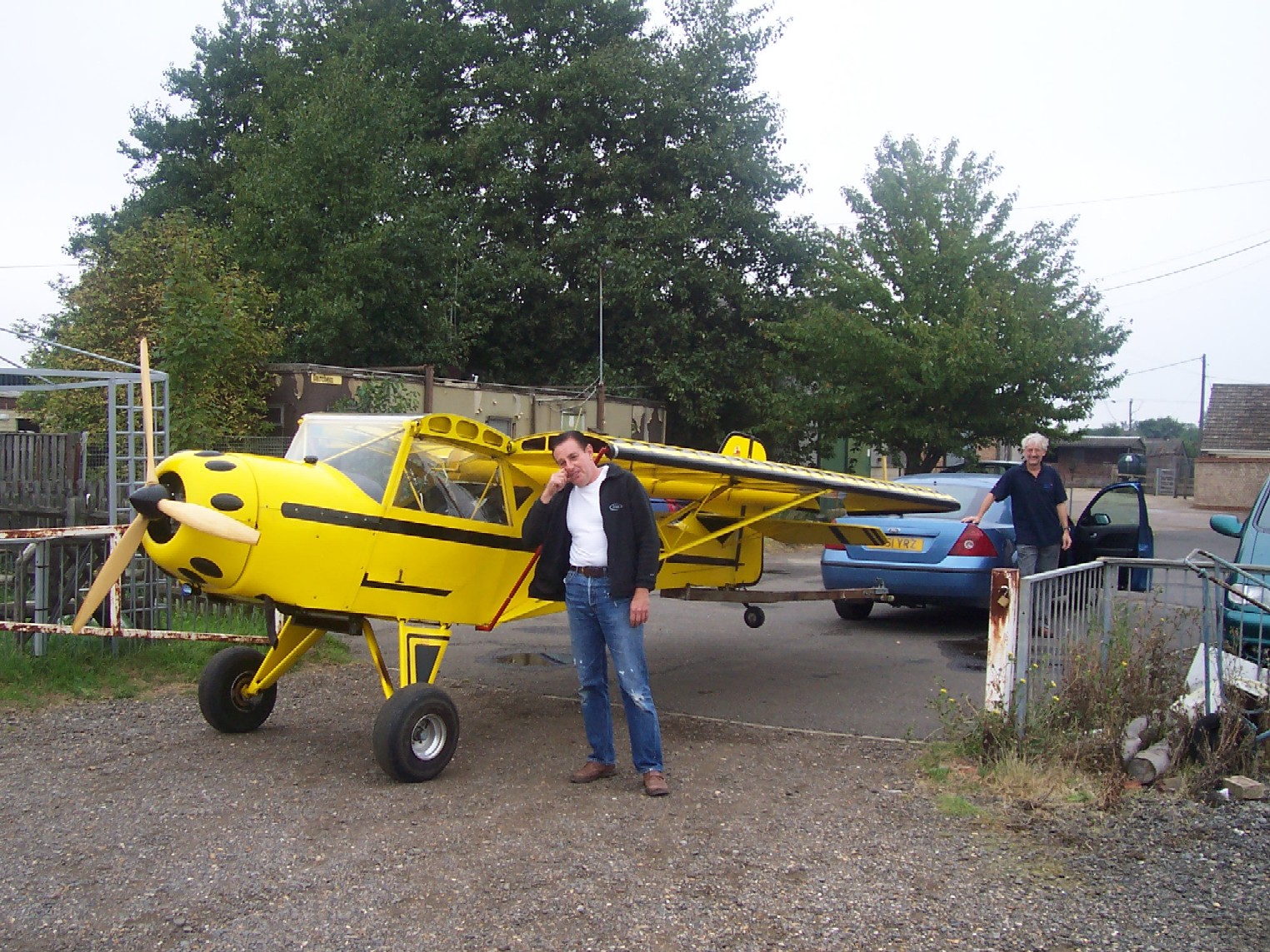

PostPosted: Wed Jan 07, 2009 5:38 am    Post subject: Trailering a Kitfox Reply with quote
Here is a picture of my model 2 being towed away from my UK airstrip with
the original tow kit as supplied by Denney and as designed by the original
engineers, I assume this because the attach points are built into the frame.
Slightly blocked by me and my feigned tears (sorry) you can see the red spar
brace installed to give the front spar some support and mainly to stop
vibration at the attach points. Not in the picture are 2 small red braces
that secure the wings to the tail assembly so they cannot swing out in
transit.
Note that the wings are most definitely not level, but are carried as low as
tailwheel clearance will allow. I make an assumption in saying it was
designed that way for all the aerodynamic reasons I have stated in previous
posts, but it was certainly designed to be that way.
The limitations of towing a Kitfox this way are clearly stated in the
owner's manual - don't go over 40mph or farther than 10 miles. This is due
to the size of the wheels, bearing tolerances, narrow wheelbase, and
aerodynamic safety considerations - it could easily flip over in a crosswind
or updraft.
I choose to trailer on a flatbed with wheels strapped to the bed to
eliminate the restrictions and keep the aerodynamics the same as the
original designers intended - wings low into the wind.
Bob Brennan - N717GB
ELSA Repairman, inspection rated
1991 UK Model 2 ELSA Kitfox
Rotax 582 with 3 blade prop
Wrightsville Pa
 Filesize:  569.7 KB
 Viewed:  682 Time(s)

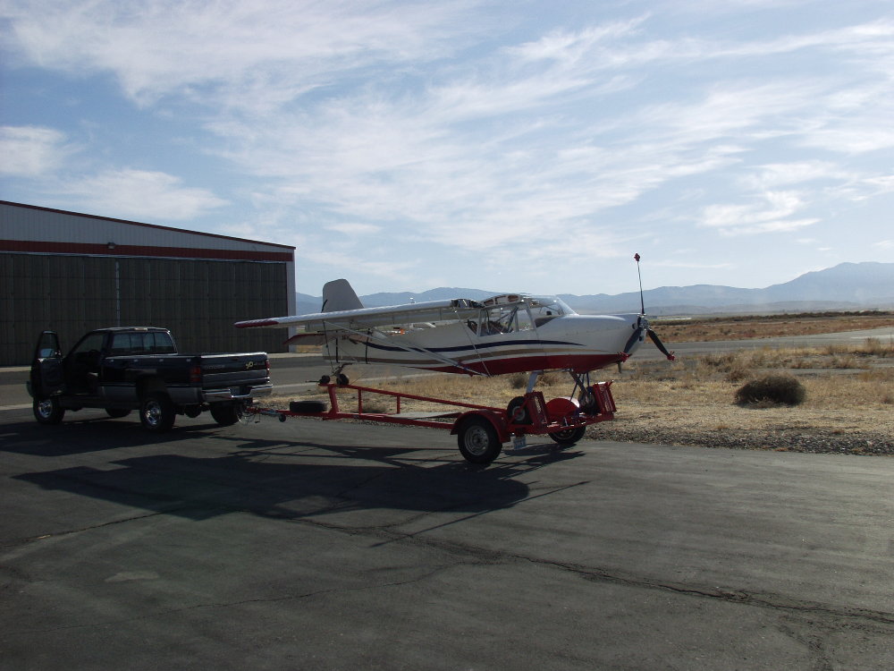

This method seems to work well. I would never exceed 55mph while towing.
Note the wing braces and safety line insuring wings stay in folded position
while towing. Vert stab protected by pad. Elevator tied in down (nose
down) position via control stick. The transport kit is avail from
KitfoxAircraft.

Good picture Vic, with the wings pitched down into the wind at what I would
consider the perfect angle exactly the same as the towbar kit. I sure hope
this picture isn't representative of what others have called "wings level"!
What are the thingies on the prop tips if you don't mind my asking? I
promise not to start another thread about them....

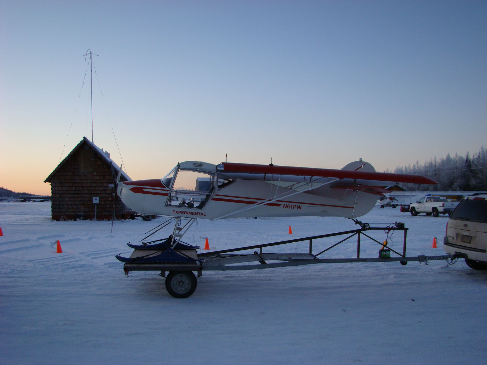

you are right, the wings are not perfectly level, but the tail is not sitting on the deck either.... I have not put the incidence meter on it so I cant give you a exact degree.

Leonard - from the picture Vic Baker sent(attached) I would guess the wings
are between 5 and 10 degrees down into the wind, in my opinion a good angle
for trailering but certainly nowhere near "level". In my most humble opinion
"level" means level means 0 degrees to the wind, which I have been trying to
determine is a bad thing or not.
Trailering using the factory-supplied towbar or tailwheel-down "on the deck"
puts the wing incidence angle at between 10 and 15 degrees down I estimate,
and should be towed within the factory recommended range of no more than
40mph. If I were to tow my bird any distance or at any speed I would install
the braces and raise the tailwheel to between 5 and 10 degrees down, but
never to "level".

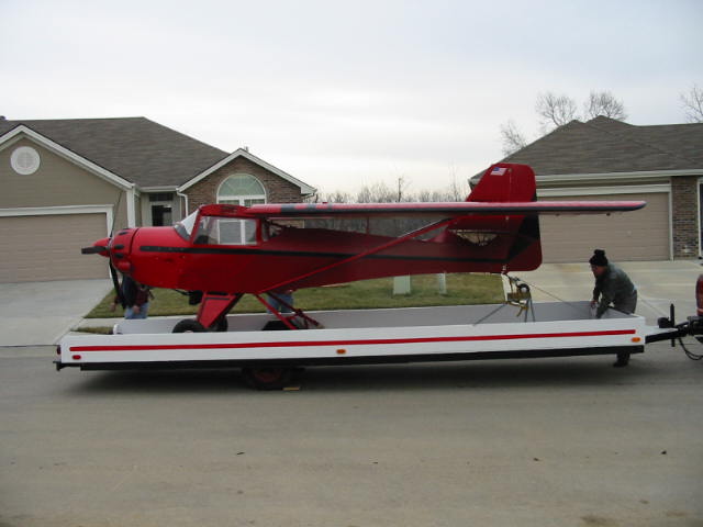

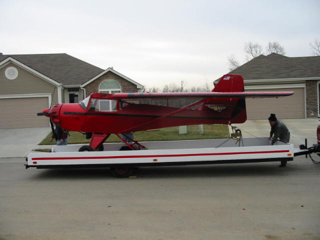

Kirk Hull's picture (hope you don't mind me attaching here Kirk) shows a
