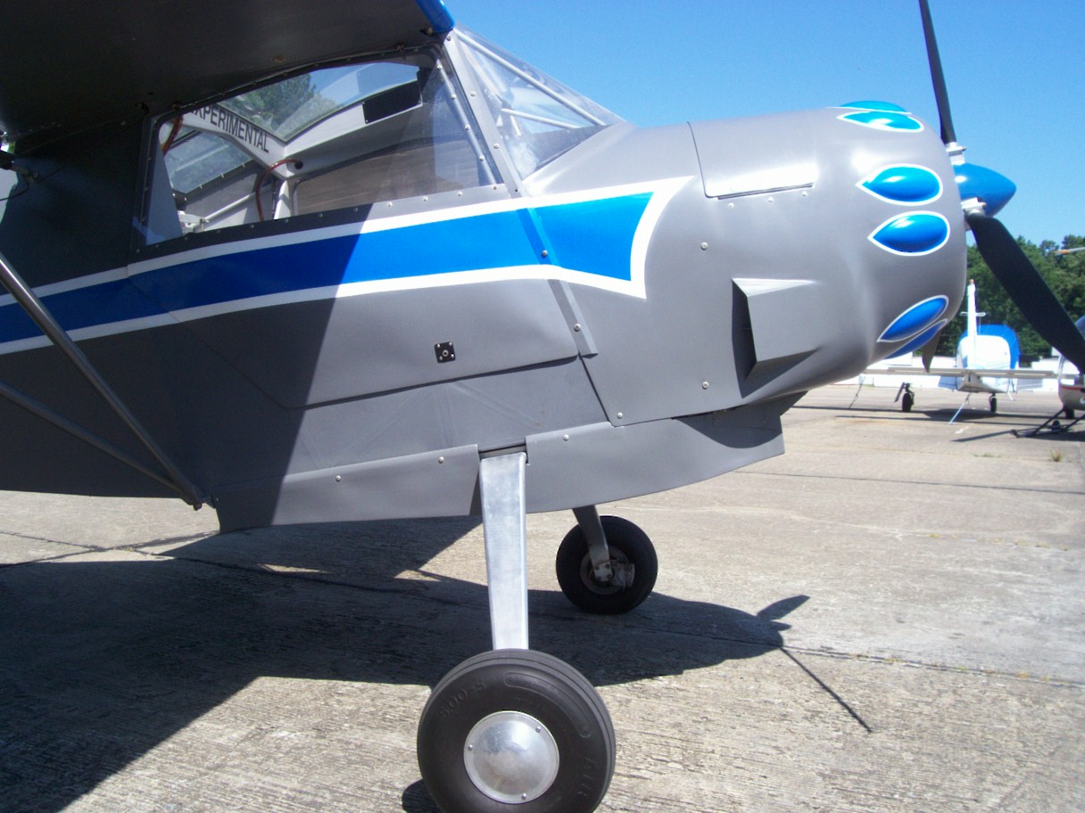

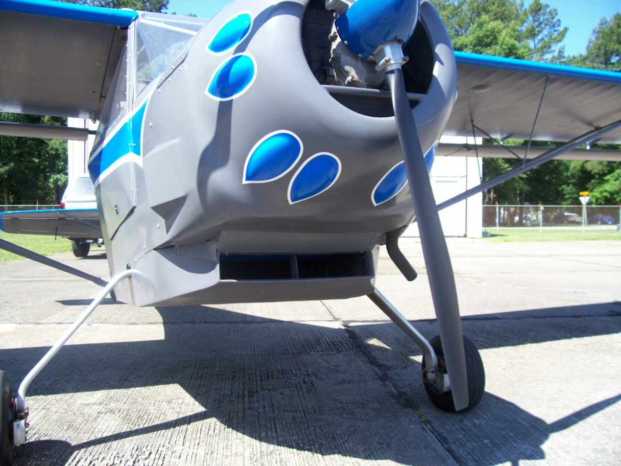

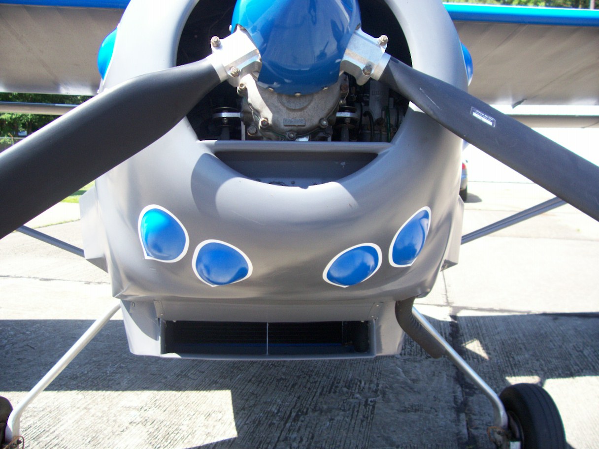

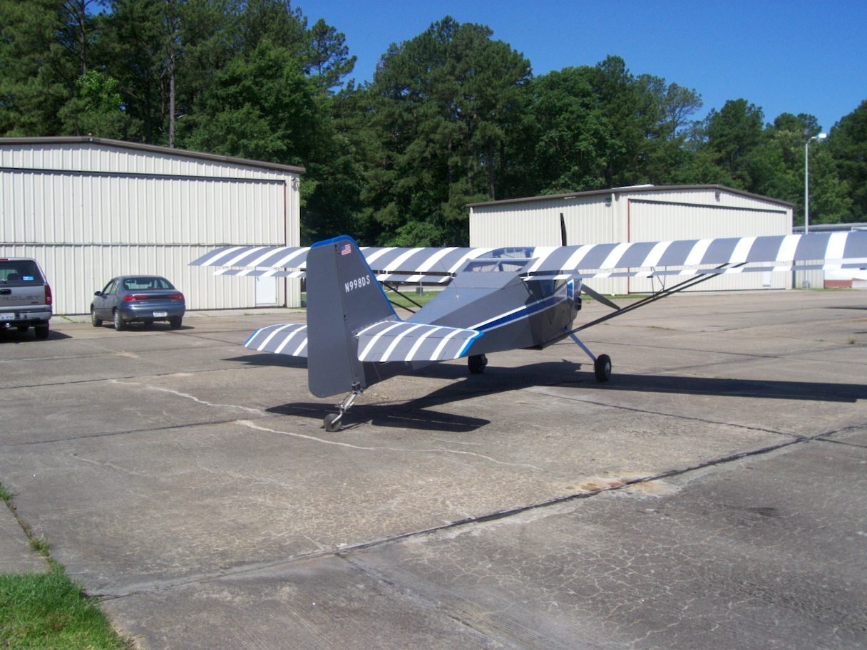

I finally made a couple pics of my cowl/radiator mods. Not too good at
sending pics so hope this works without making the list manager mad.
Pic 1198 New white paint scheme on wing tops after replacing all the 2"
tapes.
Pic 1196 is a side view. Note engine cowl is "ALL" one piece w/ hinged
access door on top.
Pic 1193 is another front view. Note horizontal isolation near the bottom
of the large round opening. This is a seperate isolated air inlet for the
muffler mounted heater box.
Pic 1191 is a front view with good shot of short exhaust section and side
engine cowl vents
Don Smythe
Hope this works

Don, Very nice looking mod...I haven't been folowing this thread, so forgive if I ask a redundant question. My curiosity lies with drag. You are in effect faring the spring gear so did you notice an increase or decrease in the drag?

I'd have to say if anything, it gained a little speed.  Some people like to talk about 2 or 3 MPH difference.  My airspeed varies that much depending if I carry my lunch with me or not.  For instance, today I was indicating 90 MPH (at) 5800.  Yesterday it was only indicating maybe 85 (at) 5800.  80-85 is the norm so, my speed might be up a couple MPH.  At least, it didn't go down and my cooling is much improved (I think).  Tomorrow we're going to a fly in and it's supposed to be around 95 degrees.  This should test things better.
