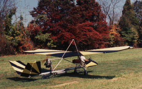

Latex painting airplanes: one easy, one a pain in the butt, and a War Story.
First time I did it was back in the late 80's, I had a Maxair Hummer that the sails were about to go bad, modified the wing so that it had a lightweight but sort of conventional rib structure and covered it with lightweight (glider) dacron from Aircraft Spruce. Don't know if they still sell that weight or not.
Attached it in the usual way with Stits Poly-Tak. Sprayed all the fabric with Sears Weather Beater Black latex paint, thinned with water enough to spray well and penetrate to both sides of the fabric, as that it how you make it stick, it has to be thin enough to be on both sides of the Dacron. Used a regular Sears quart pressure pot sprayer that I had used over the years to paint cars with lacquer, etc, don't remember how much PSI, whatever it took to make it spray right.
The parts I wanted to be yellow, I went back over & sprayed white, and then again with the yellow. It went pretty well, the weight was about 8 pounds heavier than with the original slip on sails and tube ribs, and it was dirt cheap. I think I had $300 in it, it looked good and worked fine.
One thing you have to careful of; the Hummer's wings folded together, you had to be careful not to hang them up touching, or the latex on one wing would bond to the latex on the other and it would pull off.
The second airplane was Ed's FSII, & for whatever reason the latex we were using (don't remember the brand) did not want to cooperate with the Stits fabric. Thinning with water wasn't doing quite right, tried using windshield washer fluid - so/so, nothing worked really great. Maybe the paint brand? Maybe because the standard weight Stits was heavier and it didn't respond the same? Don't know.
We got some ex-tend (I think it was called) from the dealer as the preferred thinner/ drying time extender, and eventually we got it looking really great, but for whatever reason, it was a terrible hassle. One thing I remember was that we sprayed it with a HVLP sprayer, don't know if that helped or hurt.
Now on a totally different and unrelated topic ~ AKA War Story
Eventually I sold the Hummer , it got sold again, and again, and then ended up belonging to a guy on the coast of NC. When I sold it, it was registered and had an Airworthiness Certificate, but it probably could have been made to make Part 103, seems like it weighed about 162 pounds if I remember right. It still had all the original U/L structure in it.
The guy on the coast modified it; took off the 277 & replaced it with a 503, and added a second seat. The wings & tail were unmodified, that was how I first recognized it in the video.
I about had a cow. The fool had created a death trap, and was flying his family and friends around in it.
Original gross weight was under 600 pounds, and VNE was 65 mph.
The wings had 1 3/4" leading edge tubes, 1 1/2" trailing edge tubes, no internal drag/anti drag bracing, just flying/landing wires attached at the wing compression struts, two per side. No way there was proper structure to support what he was doing with it, and I knew he had not modified it or beefed it up, because the paint job was unmolested.
I found it one night on Youtube, he had a bunch of videos, one of which showed him taking off with a large passenger, the camera was pointing at the passenger from over the pilots shoulder, and during the climbout, the fabric in the first rib bay split fore and aft. Front spar to rear spar. The passenger looked like "Is it supposed to do this?" The flight continued on for several minutes.
The next day I called Southern Region FSDO and told the man what I had seen, that I was the builder, that the airplane was unairworthy as a 2 seater, and suggested that they might want to look into it. Never heard back from him, but about a week later, all the videos of my old airplane were off YouTube...
I'm all for minding my own business, but when some idiot modifies an airplane that I built in such a way that it is guaranteed to kill some innocent passenger, and give "ultralights/homebuilts" a black eye; naw - that don't work for me.

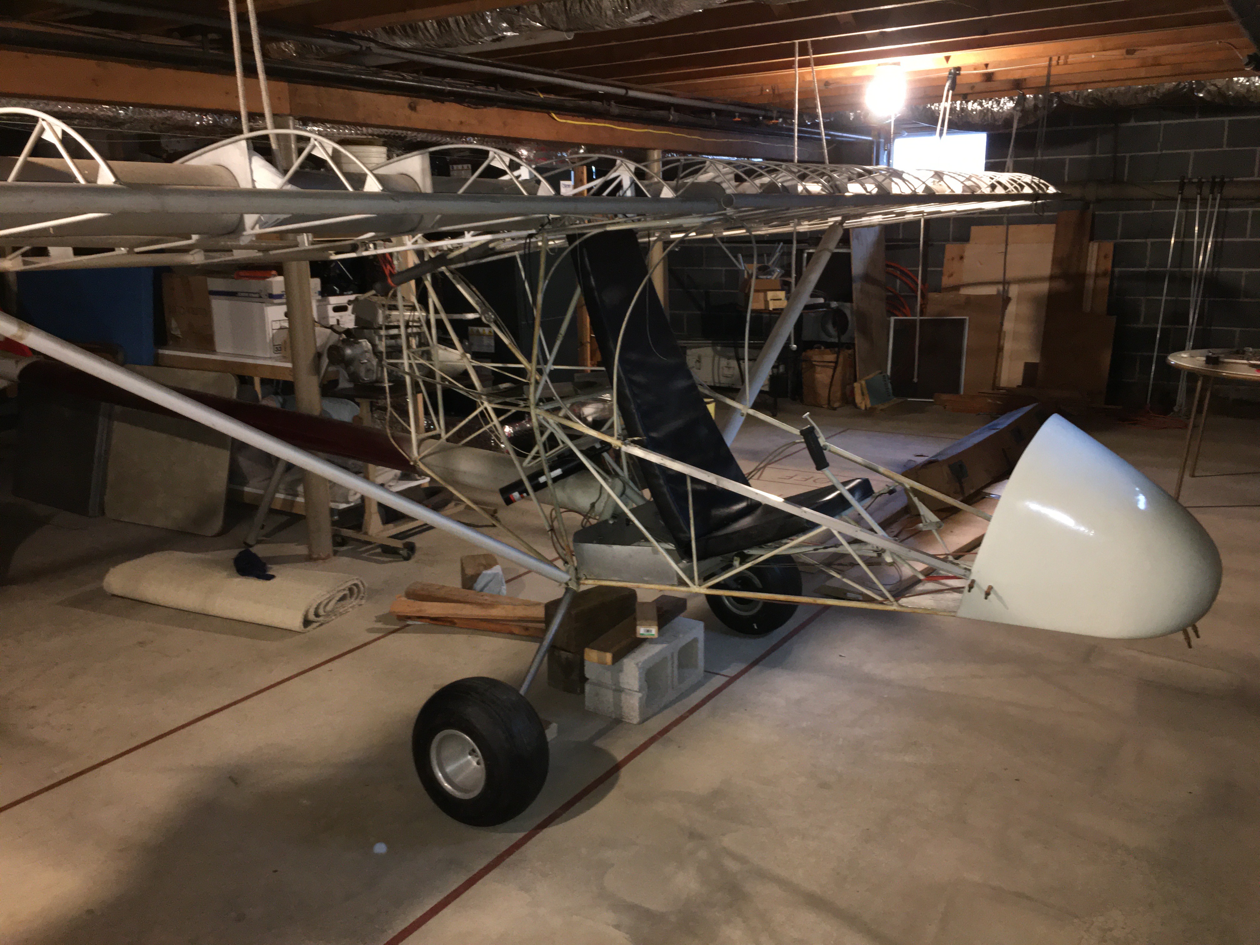

PostPosted: Fri Jan 22, 2021 7:47 am    Post subject: Original Firestar Reply with quote
Hi Guys, and Girls?,
Are there any Girls on the list?
Thanks for the responses about covering. I now have enough gumption and, not wanting to pay any attention to the cr*p going on out there, I started to reassemble my Original Friestar.
I hope you all are well.
Happy New Year !
Ed
