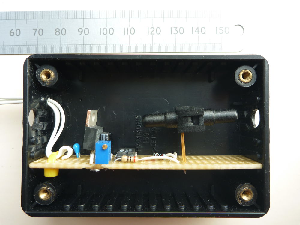

I was originally going to use Tony K's conditioning and display circuit. Tim Houlihan had planned to do the same, but we couldn't get the various bits to behave sensibly (RS-232 & Windows issues, as I remember). Tim switched allegiance to the MGL display device and got another friend to design a conditioning amplifier to interface the the RS sensor to it.
I've now adopted the same approach and attached are some PDFs and a JPEG that show what I did (op-amp circuit, stripboard layout, MGL wiring, sensor & amplifier in box). As it's not installed yet, I can't offer proof of function but I know Tim's works fine. The only potential problem is ram air pressure on the forward-facing tank vents causing change of reading with airspeed. I intend to avoid that by using Graham Singleton's vent arrangement.
in friendship
Rowland

PostPosted: Thu Nov 28, 2013 4:40 am    Post subject: sight gauge alternative Reply with quote
Rowland
isn't my vent system effectively the same as the factory setup? There will still be a +ve pressure on the tank.

PostPosted: Thu Nov 28, 2013 5:11 am    Post subject: sight gauge alternative Reply with quote
Graham - thanks for pointing that out. Until now, I hadn't noticed the forward-pointing section at the end of the ultimate vent in your diagram as posted here yesterday. I had assumed the vent would finish with a section pointing vertically down (somewhere in the flap root area?) so as to generate neither positive nor negative pressure, but probably cut off at an angle to prevent whistles.

peterz(at)zutrasoft.com
PostPosted: Thu Nov 28, 2013 5:39 am    Post subject: sight gauge alternative Reply with quote
I would suggest updating the cct/system to work on proper differential pressures - then venting isn't an issue. Ideally it would also incorporate a g-sensor such that a prolonged turn doesn't affect the fuel level reading (assuming there is some shorter duration filtering to deal with turbulence), and a switch to select avgas/mogas densities. I was planning on implementing such a system when the time came. I was also planning on a vertical aluminum tube gauge on the outside of the tank  containing a magnetic float which triggered external level switches lighting up a simple led gauge - as a backup and in lieu of the sight-gauge.
Cheers,

asarangan(at)gmail.com
PostPosted: Thu Nov 28, 2013 9:26 am    Post subject: sight gauge alternative Reply with quote
Peter
By proper differential pressure I assume you meant on one side there
will be the fluid pressure, and on the other side there will be tank
air pressure. I gathered from Paul's email that he did exactly this by
running the tank vent line to the sensor, but still sees a lag during
climbs and descents. This is most likely due to the large tank volume
and the small diameter of the vent tube. So it would matter exactly
where the vent line is teed off to go to the sensor. Closer to the
tank is better. In any case, this delay is likely to be
inconsequential because most of the spam cans I fly are only required
to have a reliable level indicator when the tank is really empty.
On Thu, Nov 28, 2013 at 8:38 AM, Peter Zutrauen <peterz(at)zutrasoft.com> wrote:

We originally copied some of Tony K's idea using the pressure transducer and op amp he designed to get a 0-5 volt signal for our GRT EIS. It worked OK for several years but there was always a problem of RF from the com transmitter causing interference when transmitting.
We have now switched to Freescale (Motorola) integrated sensors, MPXV4006DP which provide a 0-5 volt output for 0 - .87 psi. They are a differential sensor so the liquid side is connected to the water drain pipe from the tank bottom and the other side is connected to the tank vent. They only require a 5 volt supply that we take directly from our EIS. We calculated that a full fuel tank will have a head of pressure equal to about .4 psi. So we programmed the EIS so that 0 - .4 psi gives an output of 0 - 100.
We have two of these sensors, one on the port (main) and one on the stbd (reserve). In our GRT Sport EFIS we made the fuel calibration scales so that each side goes from 0 - 3 gal and when there is 6 gallons in the tank so fuel is over the saddle, then both read the same. The calibrations are in level flight attitude.
We have a sight gauge behind the seat back that is calibrated in the taildown attitude (we have a mono). We use that to confirm at the end of the flight that fuel used determined by the fuel totalizer in the EIS/EFIS is correct. We also use the sight gauge to determine how much fuel to add.
We calibrated the sensors in level flight attitude so we have a in flight check that the fuel totalizer and actual fuel used is correct. The other purpose of these sensors is to give more confidence of how much fuel is aboard when the tank is getting empty.
We've had no problems with using sensors with flouorosilicone seals and autofuel (very seldom do we use 100LL). For our sight gauge we use Tygon SE200 which has a flouoropolymer tube inside conventional clear tygon tubing. This tubing does not discolor or degrade when exposed to gasoline. Use with single barbed fittings.

jan_de_jong(at)casema.nl
PostPosted: Fri Nov 29, 2013 3:05 pm    Post subject: sight gauge alternative Reply with quote
Thank you. This seems to be the sensible solution. Temperature
compensation, gasoline compatible and inexpensive too. Without g-force
compensation but that is probably not so useful anyway. I am glad to
understand that the long lines between panel and sensor do not pick up
noticeable noise.
What kind of averaging time did you set the EIS input to?
Jan
