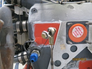

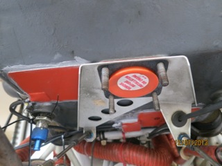

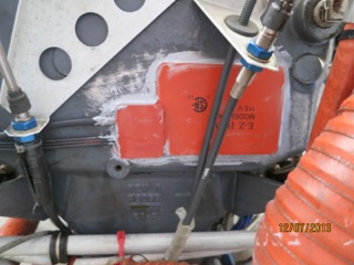

couple of pictures of my installation just in case someone is planning the same.
The installation instructions are conceptual and not directly related to IO540. Basically, place the pads where you they fit.
The throttle body and the cable bracket had to come out to accommodate the installation. Of course easiest installation during the building process.
Have not fired it up yet, 24 hrs needed to cure. Costs $185 including shipping from AS.

I'm not sure if this is compatible or not, but, my Reiff preheater works
very well and it
uses a similar sump pad (although it's more of a metal pad?)
But, it adds the addition of cylinder base band-type heaters (like a
long skinny
hose clamp) to the engine. I find those actually work very very well.
I'm not sure if you could potentially add their cylinder band heaters to
your
sump heater, but if you live in a very cold area, it may be worth it.
I find that with my Reiff, I can go fly when it's 10 degrees out and my
cylinders
will still be near 90F. I can't remember for sure, but it seems that even
on the coldest days they're still in the 70's or 80's minimum, and you get
a more even full-engine heat that way. You wouldn't want sludgy oil
in the more external passages.
The only part I don't have is their oil filter heater. I have been
contemplating
adding that one too. For sure, if I were flying today here in Wisconsin I
would prefer it....but I haven't splurged yet.

I will be testing mine during Xmas at temps about 20. My operation areas do not have the Wisconsin sub zero temps. That's the reason I settled for the pads.
They heat up to 300 but keep the oil temps at 165 with a thermostat.
Will give a report next year. Thanks for the comparison.

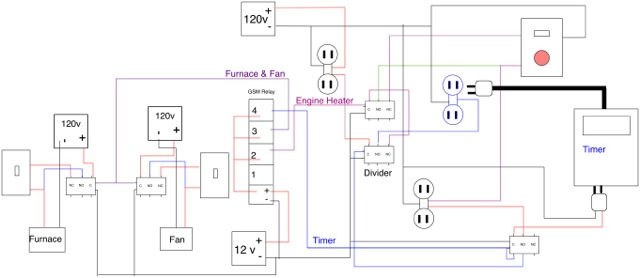

Here is a schematic for those of you in cold areas who would like to preheat your engine or hangar by SMS texts. It uses a Waferstar SMS relay with 7 available relays. It's available through DHGate on the web. The rest of the parts are Radio Shack DPDT 12v switching 110v relays and about 1.5a 12v source. The SMS relay will send a text message to you telling you that the requested action was done. I used an SMA connector to RG-58 coax to make an antenna going out the wall of my metal hangar. I stripped the exterior braid the length of the factory antenna and that yields a signal strength of under 10 out of 32 which seems to be good enough. I use an H2O Wireless card from Best Buy at $10 for 3 months. Texts are $.05 and there will be 4/use.
I use it to turn of the engine heater or the furnace and ceiling fans either together or singly. Any combination of the seven relays is possible. The timer section of the schematic is used when I want to leave early in the AM and don't want to getup the send the message 2-3 hours ahead of time. The timer is preprogrammed for any day with a start time of 3AM and turns off at 9AM. The system is wired so that heater, furnace and fans can all be turned on by hand at the hangar.
There was no electrical inspection done this so I have no clue if it would pass.
