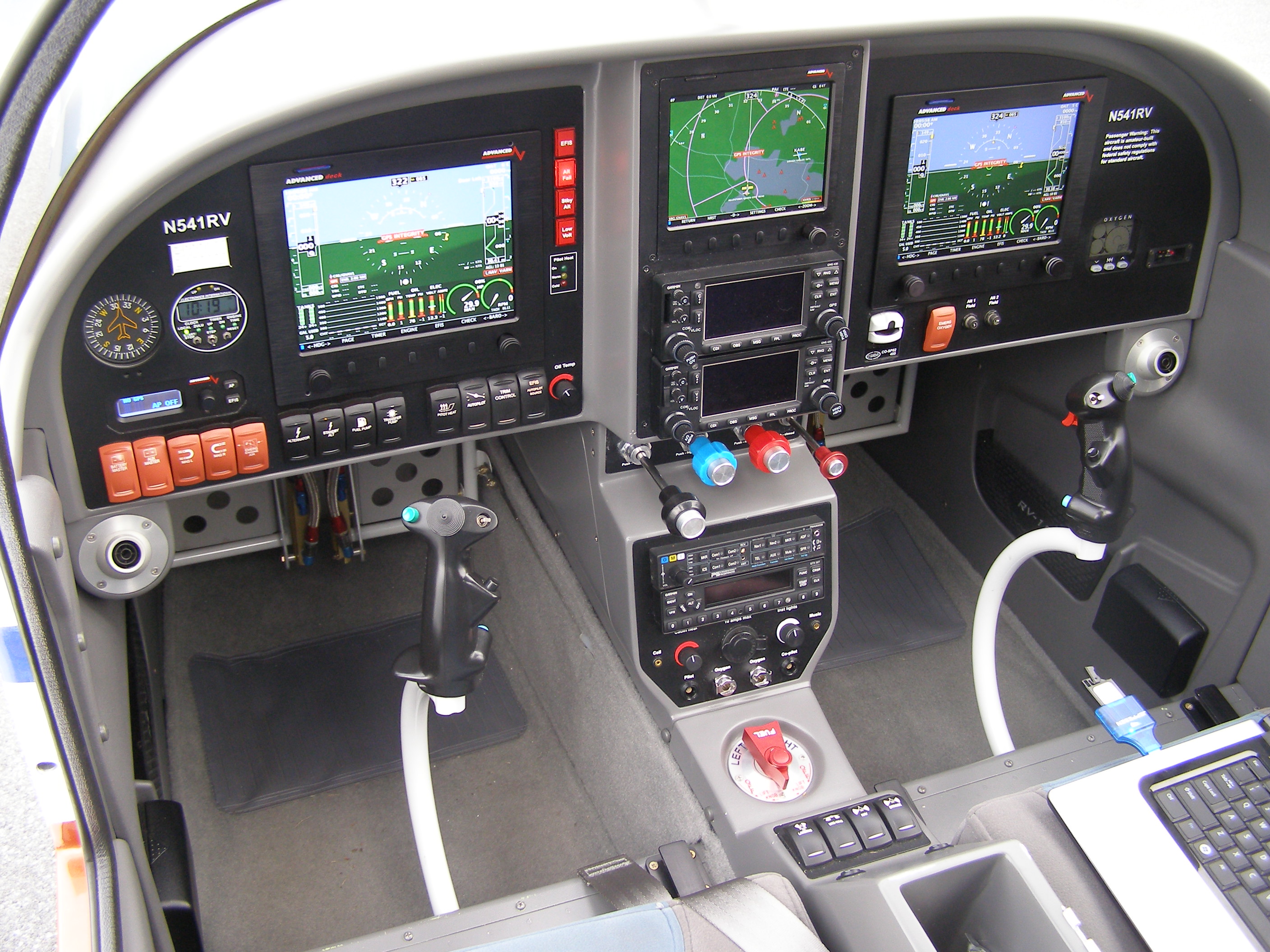

I have a three screen AFS system, 2- 4500's and a 3400 in a symmetrical
panel layout. I've been flying the plane for 2 years now and have done a
pretty good amount of IFR work including approaches. I have about 30 hours
in IMC with the plane and really enjoy how the system works. I've primarily
shot GPS approach in actual, both with and without vertical guidance, and
just a few ILS approaches. I feel the AFS system coupled to GNS navigator
and the AFS/tru-trak autopilot have been truly awesome. The display of
information and the organization of the buttons and menus is very intuitive.
I believe those with the 5000 series products have it even better with more
buttons and less menus. Another feature that is really intuitive is the
operation of the autopilot via the knobs on the EFIS, it makes the
operation of the whole system, especially in IMC, quite straight forward.
Lastly, when I designed my panel I thought that a separate screen, (the
3400) primarily for showing the moving map and geo-referenced approach
plates was going to be very useful. I now think of it as essential. In
terms of situational awareness, I think the center screen is one of the
best tools going. I also have Navworx ADS displaying weather and traffic
on the center screen. Flying in the Northeast with traffic on screen is
spectacular.
Lastly, I installed the AFS AOA system when I built the plane but did not
turn it on during the first year of flying, I had never used AOA before and
just wasn't ready to wrap my head around another gizmo. Then I turned it
on and calibrated it. I'm now a AOA evangelist. It totally changed
(improved) how I flew and especially landed the plane. Since the RV-10 has
such a wide range of capability from single pilot and unloaded to super
fully loaded with all seats occupied, knowing exactly where you are with
respect to lift reserve is just huge. My advice, if you don't have it, get
it, if you got it, turn it ON!
In my RV-8 I'll use AFS gear again.
