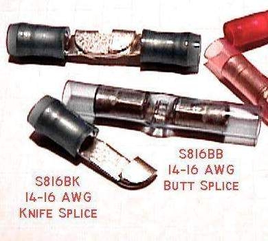

Do you plan to remove the wings often? The most robust
service connections are knife splices covered in heat-
shrink. Given the small number of wires, I'd personally
go that route.

If you can wire it up without junctions, so much the
better. Just put a service loop of wire at the wing
root . . . 3-4 inches in diameter. This will offer
'slack' from which future splices can be implemented
should it become necessary.
I was thinking of a using a triple Seal-All type conductor for the
disconnect at the wing root but hadn't considered the knife
splices. Actually, to my knowledge, I have never employed a knife
splice in any of my wiring.
The ideal configuration is no connector at all. Once
you break the wires, putting them back together is
pretty much a toss-up. Cessna started using Mate=n=Lok
plastic connectors at the root and other locations
as a production aid back about 1967. The car-guys have
been doing it too for decades. Risks are low no matter
what technology you choose.
