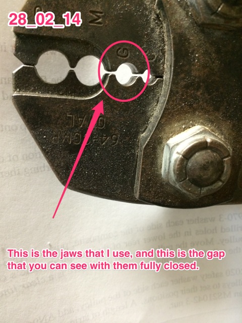

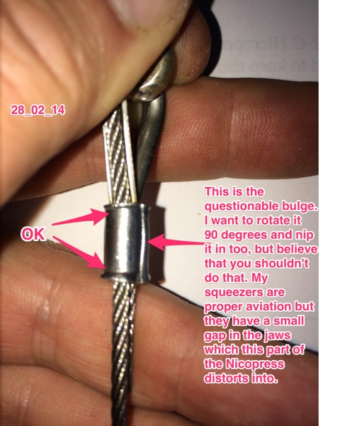

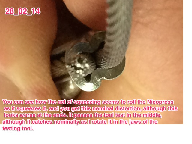

I’ve attached 2 photos of my Nicopress squeezes, and 1 of the jaws of the tool. Any input gratefully received.

You can look at my Nicos in two pages at below link. They look like yours. My large tool like yours came with a gauge, you can adjust crimp size. I am pretty sure 43.13 would give you dimension. If you are only going with one Nico, leave some cable sticking out, if two Niocos, then you can capture end with second. I use Teflon shrink tube, needs lots of heat and expensive, but holds up to nasty sharp end of cable.

Hi Tony You must leave an inch long tail after the sleeve and shrink a short length of electric wire sleeving on to that end for protection.
Two things you can do also, conduct a proof load test, I don’t know the loads but Europa may, or you could drop an email to Andy Draper at the LAA engineering dept he would know. The other way of being certain is to build the cables with two Nicopress sleeves on each end. I know its more weight but “Piece of mind”is worth a few ounces .

As Richard stated, I used two Nicopress Sleeves for " peace of mind".
Good recommendation.

So did you use two on all the ends, from pedal all the way thru to rudder?

Yes I did. The 25mm long tail Richard talks about, instead of using tape I use an additional sleeve.

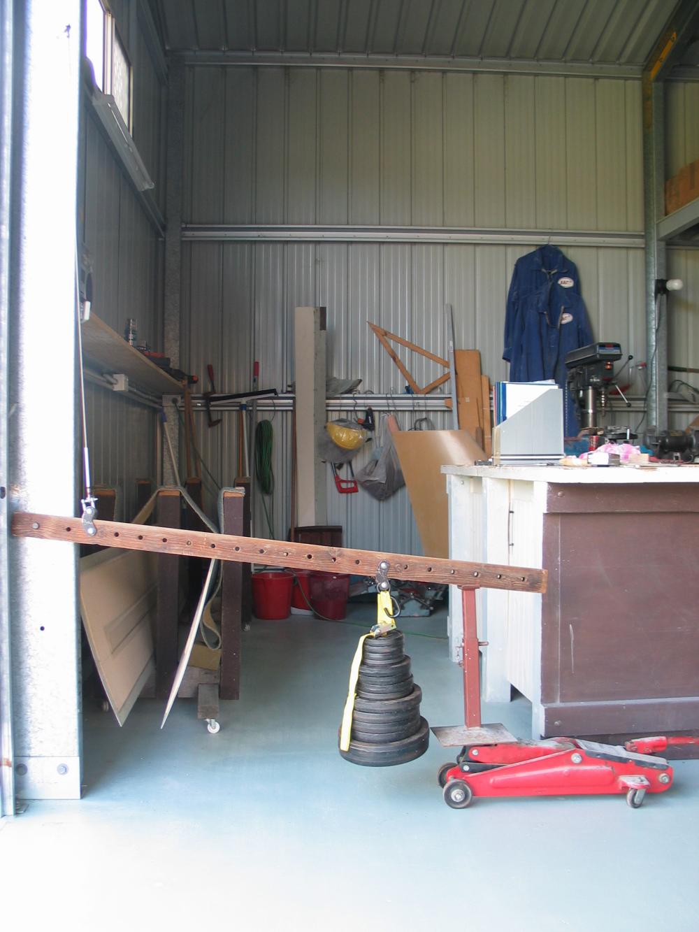

The final proof is in the testing.
AC43-13-1b chapter 7 gives a chart and testing procedure.
Attached is a picture of  my cable test rig.
When I was doing the actual test I had a large ladder between myself and the victim. If they break they can go with a bang.

Thanks for responding. That looks a great tester. With the various holes, did you do the maths to calculate and what is the formula you use?
Good setup. I am impressed. I believe you are close to flying. Is that right?

The beam is part of a sash clamp I used for making window frames many
years ago.
I set it in the nearest hole to give me the weight I required and
adjusted the rest with the much under used weights from my barbell, then
carefully lowered the jack and kept my fingers crossed.
I´m sure a Man of your ability can do the maths for whatever you have
available.
The check is 60% of 700 lbs for 3 minutes I think, but read the document.
Incidentally, the breaking strain of a well made Nicopress is about 1.5
times the minimum breaking strain of the cable hence I only used one on
the ends of my cables.

On 1 Mar 2014, at 13:02, Lance Sandford <sandford(at)melbpc.org.au> wrote:
Tony
The beam is part of a sash clamp I used for making window frames many years ago.
I set it in the nearest hole to give me the weight I required and adjusted the rest with the much under used weights from my barbell, then carefully lowered the jack and kept my fingers crossed.
I´m sure a Man of your ability can do the maths for whatever you have available.
Incidentally, the breaking strain of a well made Nicopress is about 1.5 times the minimum breaking strain of the cable hence I only used one on the ends of my cables.
I was hoping to be flying by mid year until my neighbour conned me into helping lay 160 meters of concrete during our 30 Degree, 70% humidity days, which has slowed build progress a couple of Months.
Lance

>> On 1 Mar 2014, at 11:46 am, Lance Sandford <sandford(at)melbpc.org.au> wrote:
>> Tony
>> Regards
>> Lance Sandford
