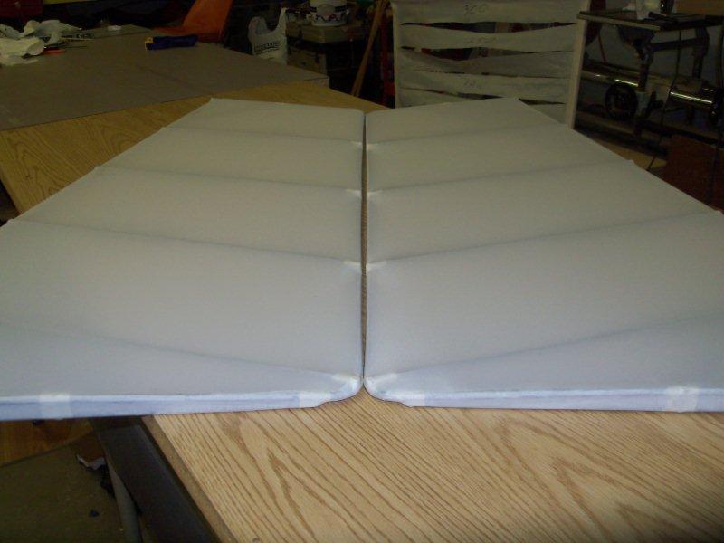

Covering has started! I have been practicing with some old 2.7 oz fabric on
all kinds of makeshift frames using some old out of date Poly-Tak. Just
getting used to gluing and shrinking technics again, as it has been nearly
18 years (Yikes!) since I have messed with any of this stuff.
Anyway, this weekend, I managed to get the elevators covered with 1.7 oz
fabric. Not as pretty as I would have liked, but I think it will pass once
the tapes are applied.
I managed to work my way up to 325° in 25° increments. Watching the
trailing edges, I decided to stop there. Here is a picture of the two
elevators lined up so you can see how much they are starting to warp. I
wish I had lined them up like this before covering for a comparison, but I
did not think about it. I have to assume they were originally straight.
What do you think, did I go too far, or is this OK?
Thanks in advance.
Stuart

So what's the problem? The fabric is very strong and you want it tight. Remember we are looking at trailing edge to trailing edge so it looks twice as bad as it is and it doesn't look bad. Be sure to shrink the whole piece the same so that you don't get any warping. Lots of chafing tape, looks good. Keep going.
Rick Neilsen

Looks great Stuart!

Looks good to me.

They look good. I don't think the trailing edges are much of a concern. I actually went to far the first time and warped the leading edges so much it was impossible to install the hinges. After that I put a straight edge on the L.E. and shrank until they just started to bend. I didn't worry about the trailing edges.

It looks very good to me, realize this is a slow moving airplane and being a little off will have very little effect on flight characteristics. Keep up the good work and don't be afraid to tackle the big wings....looking goooood....

What I should have said is I put a straight edge on the L.E. of the movable surfaces and on the T.E. of the fixed surfaces to make sure the hinges could be installed.

when covering the wings I found the trailing edge did not warp but the ribs bowed out of column. I would keep an eye on this when shrinking the wings.
FWIW
Jason

Thanks for all the advice, I am going to tackle a wing next.
