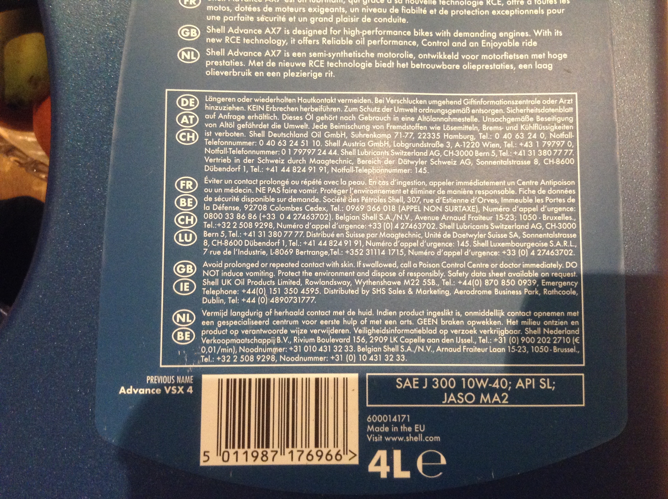

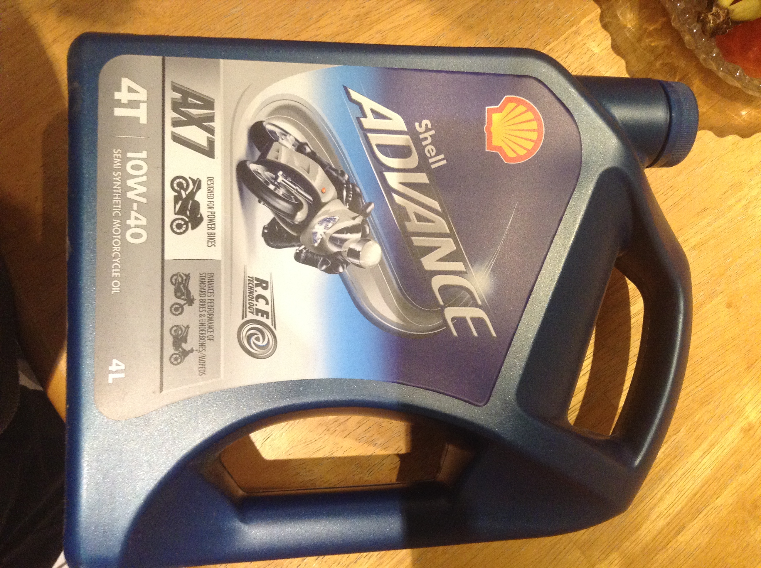

PostPosted: Fri Mar 14, 2014 1:28 pm    Post subject: oil Reply with quote
Sent from my iPad
Hi Frans
As you can see from the labels it a semi synthetic oil and it's previous name was vsx 4
Yes the Scillies Isle is a great place to visit, St Mary's is the main island with a interesting approach, you will need PPR and the airfield is shut on Sunday,
bob and me flew into helgoland last year on your recommendation and really had a good time
Will try for a revisit some time soon,
Ivor
