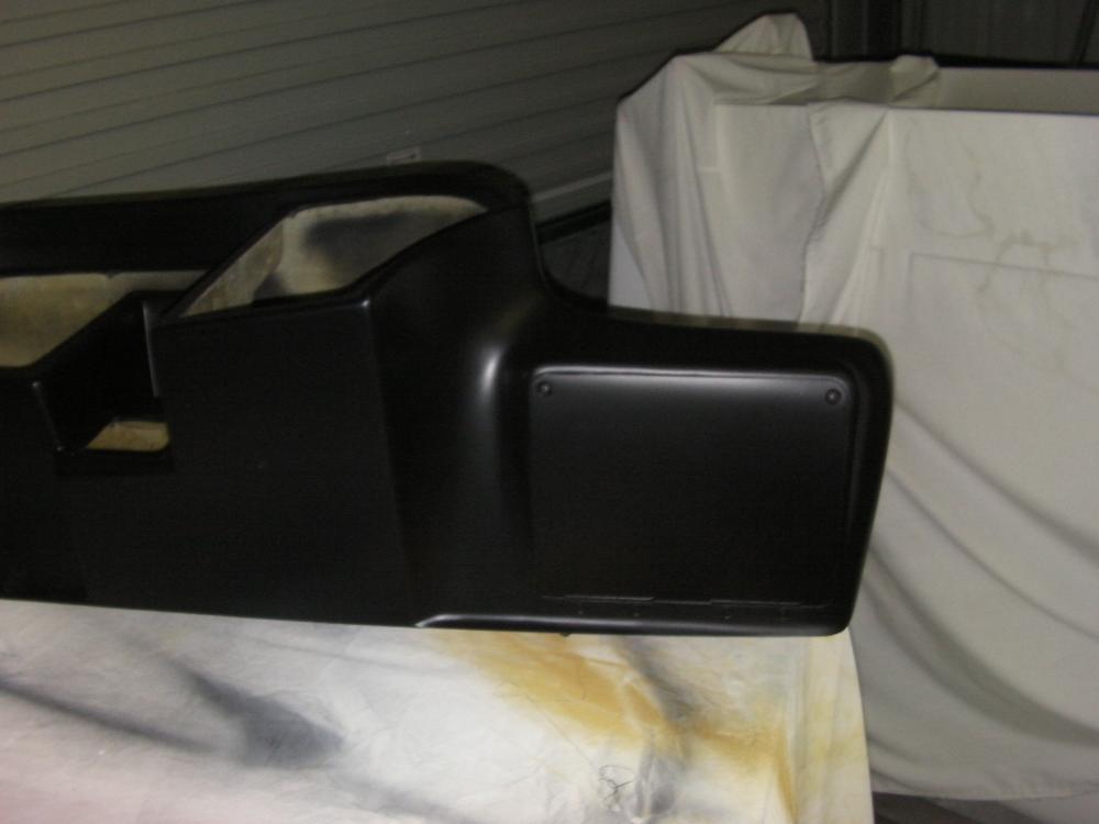

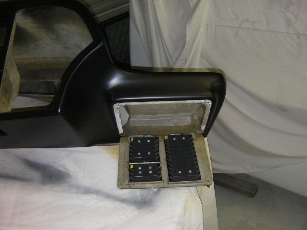

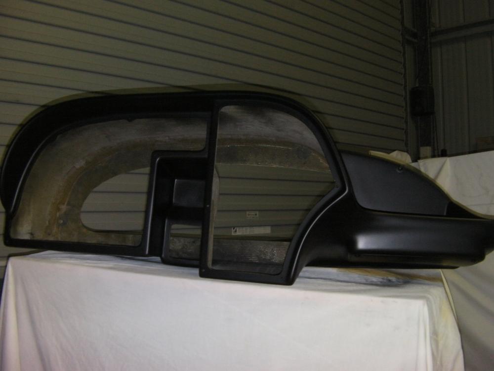

Tony - yes, that's what I have done. See:
http://www.rowlandcarson.org.uk/aviation/europa_435/shelf_cut.php
for the hole I hacked in the parcel shelf, with the fuseblocks placed to show how they will fit.

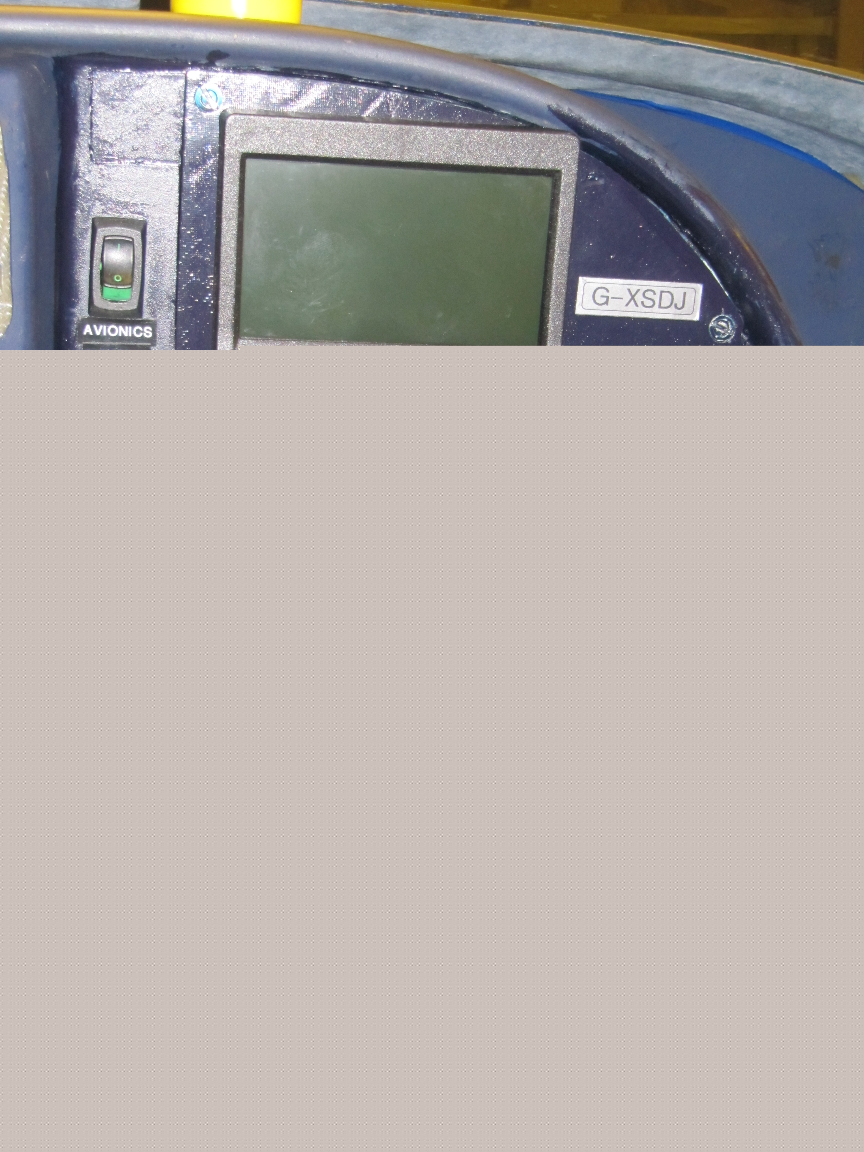

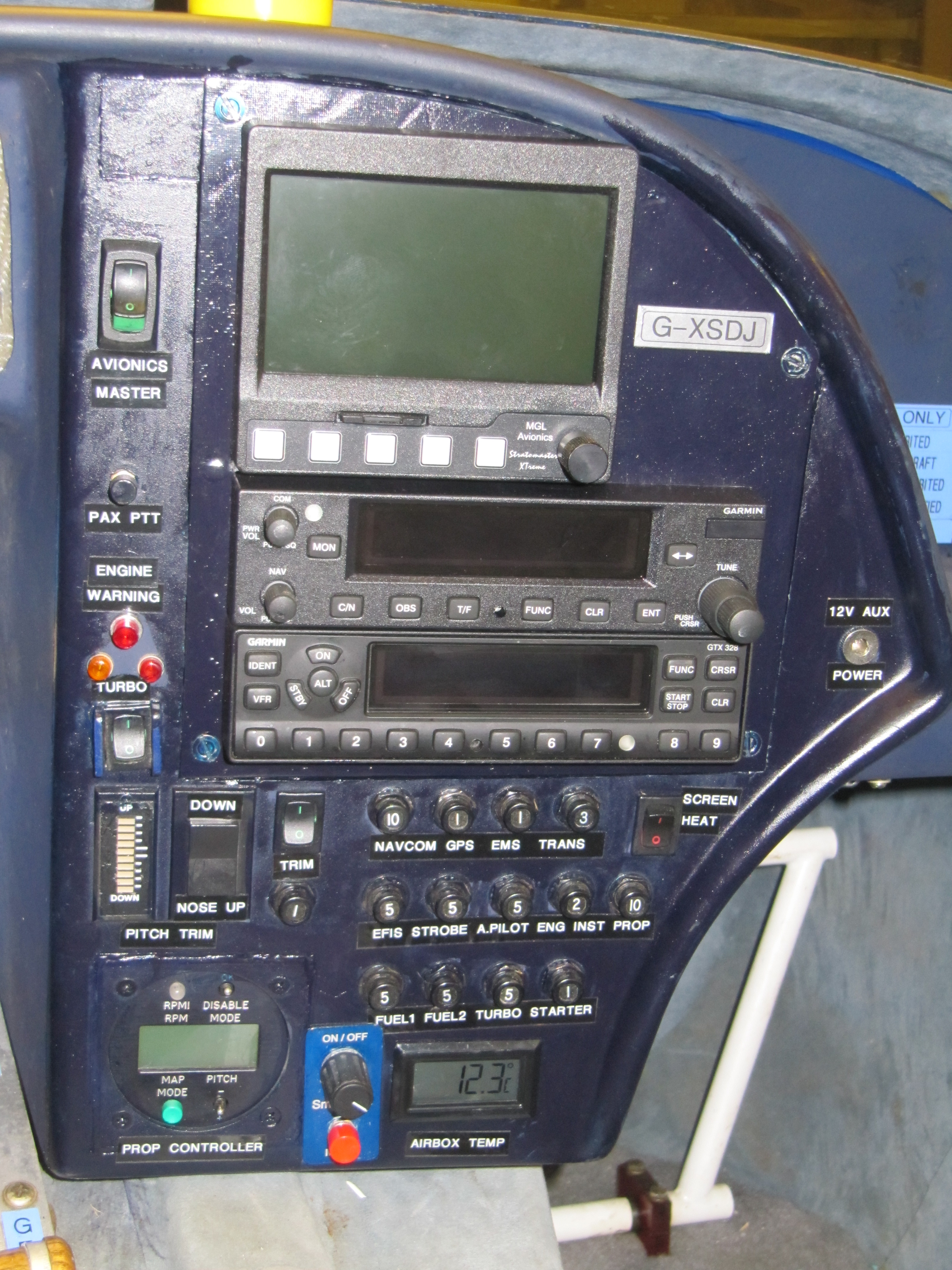

Tony & Rowland, I have a slightly different philosophical
approach to this question. A fuse may well go as part of
some in air failure just possibly accompanied by fire or
smoke. Time spent working out what is happening threatens
your safety. As with an engine failure serious distraction
and stress can lead to speed decay and a stall/spin
accident. So I prefer my fusing system to be out where it
is immediately obvious what has blown and for this reason
I recommend switchable circuit breakers, all labelled and
readily visible. They have the added benefit of readily
allowing switching off of circuits to deal with
emergencies such as regulator failure. Regards, David
Joyce, G-XSDJ

davidjoyce(at)doctors.org
PostPosted: Mon Apr 07, 2014 4:43 am    Post subject: Parcel Shelf tray door access for fuses, CBS Reply with quote
Rowland, I don't dispute the electrical safety. It is just
the distraction of having to dig around to make a
diagnosis and alter any circuitry rather than having it
plain obvious, right under your nose. I am strongly of the
opinion that anything that increases the
workload/distraction factor in an emergency is a
thoroughly bad thing and leads to a lot of stall/spin
deaths.
Regards, David

On Apr 8, 2014, at 5:51 AM, A. Buess Aviatik <ykibuess(at)bluewin.ch> wrote:
Tony,
I followed also Bob N's philosophy and used circuit breakers only for the
regulators. Blown fuses need careful analysis which is only done after
landing. The attached picture shows the fuseholders of all three busses
underneath the picnic tray.
Regards, Alfred

PostPosted: Tue Apr 08, 2014 3:03 pm    Post subject: Parcel Shelf tray door access for fuses, CBS Reply with quote
Alfred
Great minds think alike. See attachment. I extended the front edge to

On 08/04/14 22:51, A. Buess Aviatik wrote:
Tony,
Regards, Alfred
