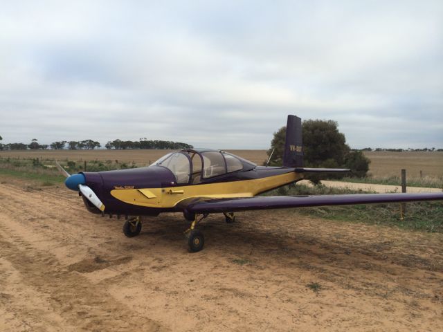

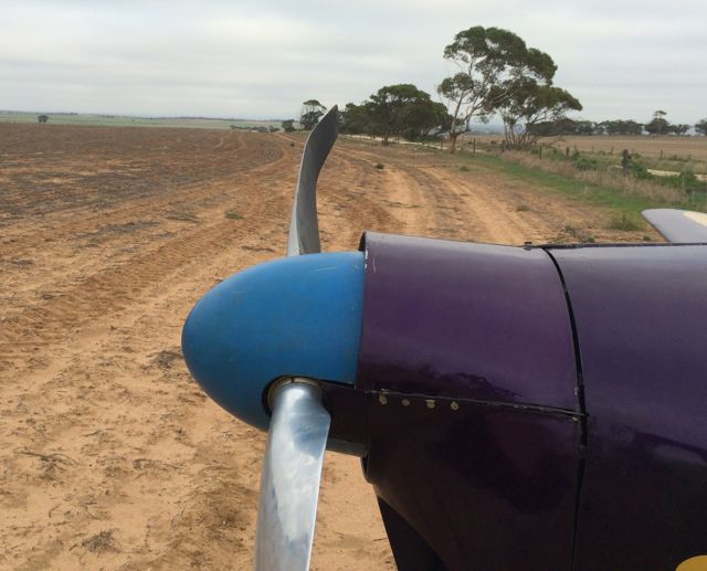

I’ve attached a couple of photos showing why we need to remove the prop.
David Smile
[img]cid:5E2A2FFA-F81E-499A-898B-F729F66DC9B9[/img][img]cid:EA004B8A-0C72-4883-AD0E-A2CE3FB5BDB6[/img]

Poor Eagle. Best of luck with the repairs!
