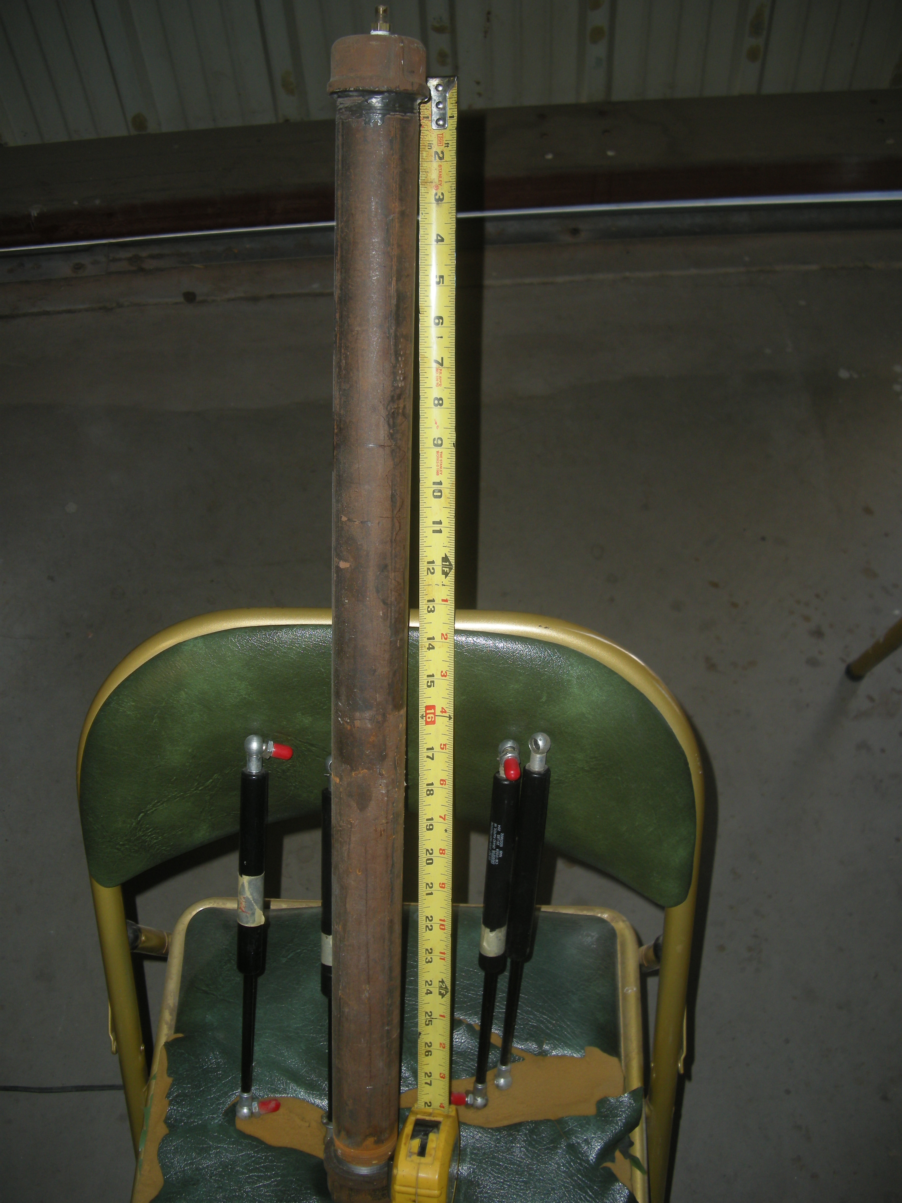

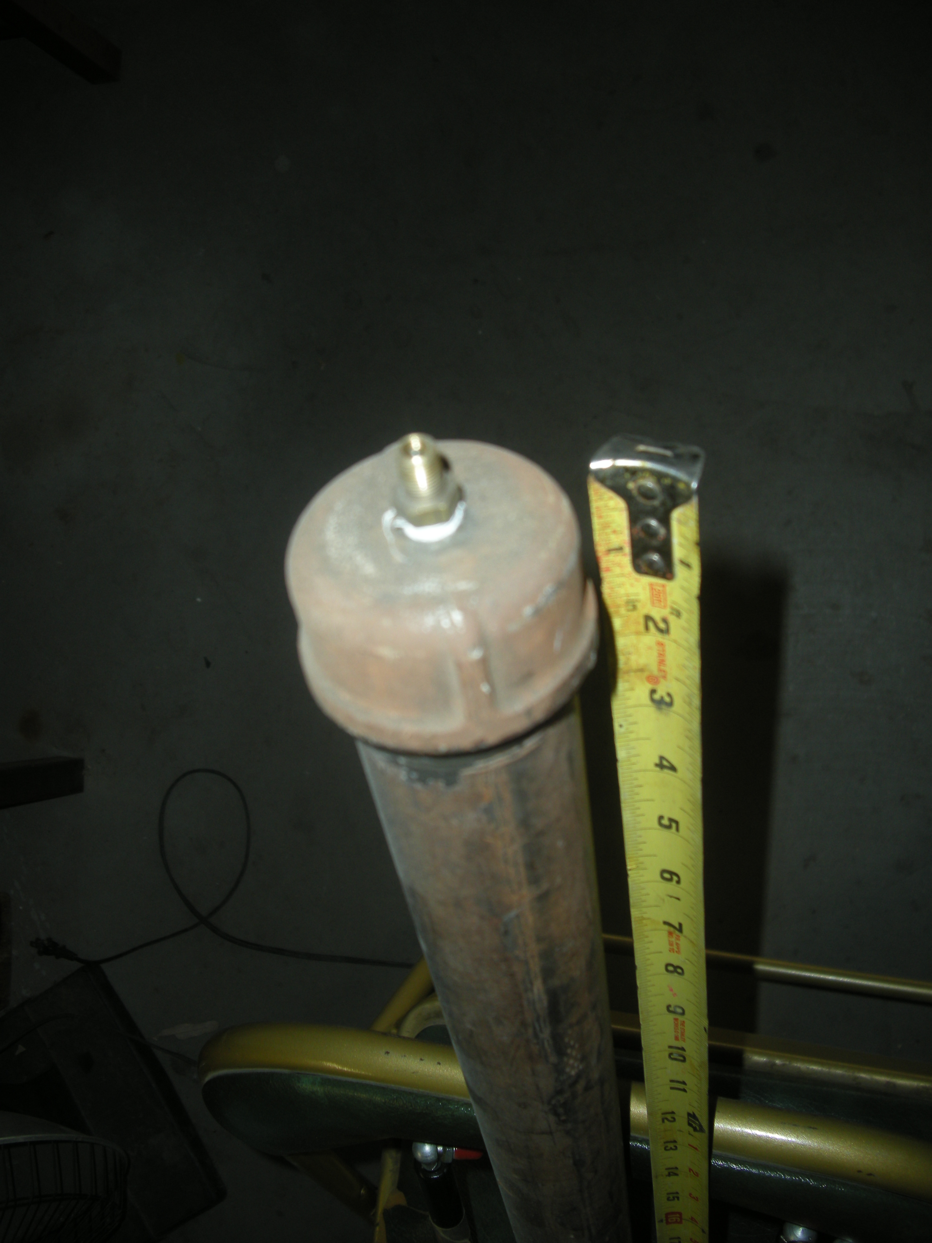

Thought I would post photos of my gas strut charger. It holds 4 of my struts. I could have made it smaller. I couldn't find a replacement for the kit supplied Supra struts and at 25lbs. they were not strong enough. The plane was built so I didn't want to change lengths and have to install new or relocate mounts. This worked well for me but if you can find the correct Gurdon, that would be simpler.
Tim

My bottle doesn't have a gauge and when it is full I think it is less than 2000#.

Thanks for you reply, what pressure do you push the nitrogen up to?
