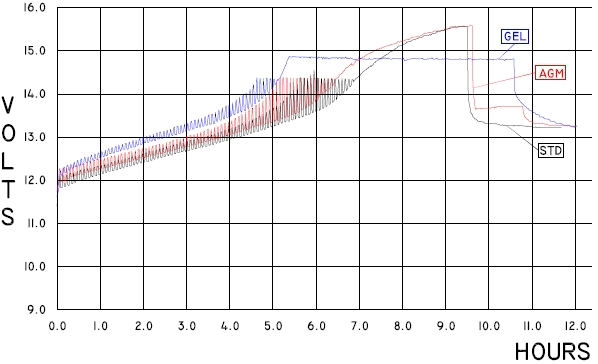

A few weeks ago I spoke to my disappointment for the
demonstrated performance of a new Schumacher XC75W
charger with lots of push buttons and a digital display.
Three successive recharge cycles of the same battery
produced these profiles . . .
[img]cid:.0[/img]
The first recharge was in the "AGM" mode, consistent with
the configuration of battery. As you can see, this profile peaked
at over 15.5 volts . . . The next time I tried the "STD"
mode with similar results. Finally a recharge cycle in the "GEL"
mode produced a perfectly acceptable performance . . .
I forwarded this data to Schumacher asking for an opportunity
to talk with an engineer . . . I have yet to hear from them.
From this experience I must conclude that any tendency
toward blind faith in Schumacher's ability to produce a
well crafted recharge profile is not well placed.

You spoke to an observed output of 14.2 volts . . . which
is in no way abusive to the battery. But the Rest Of the
Story speaks to the complete recharge profile as plotted
in the data cited above. I'm doing a study of both lithium
batteries and suitable chargers . . . watch this space.
