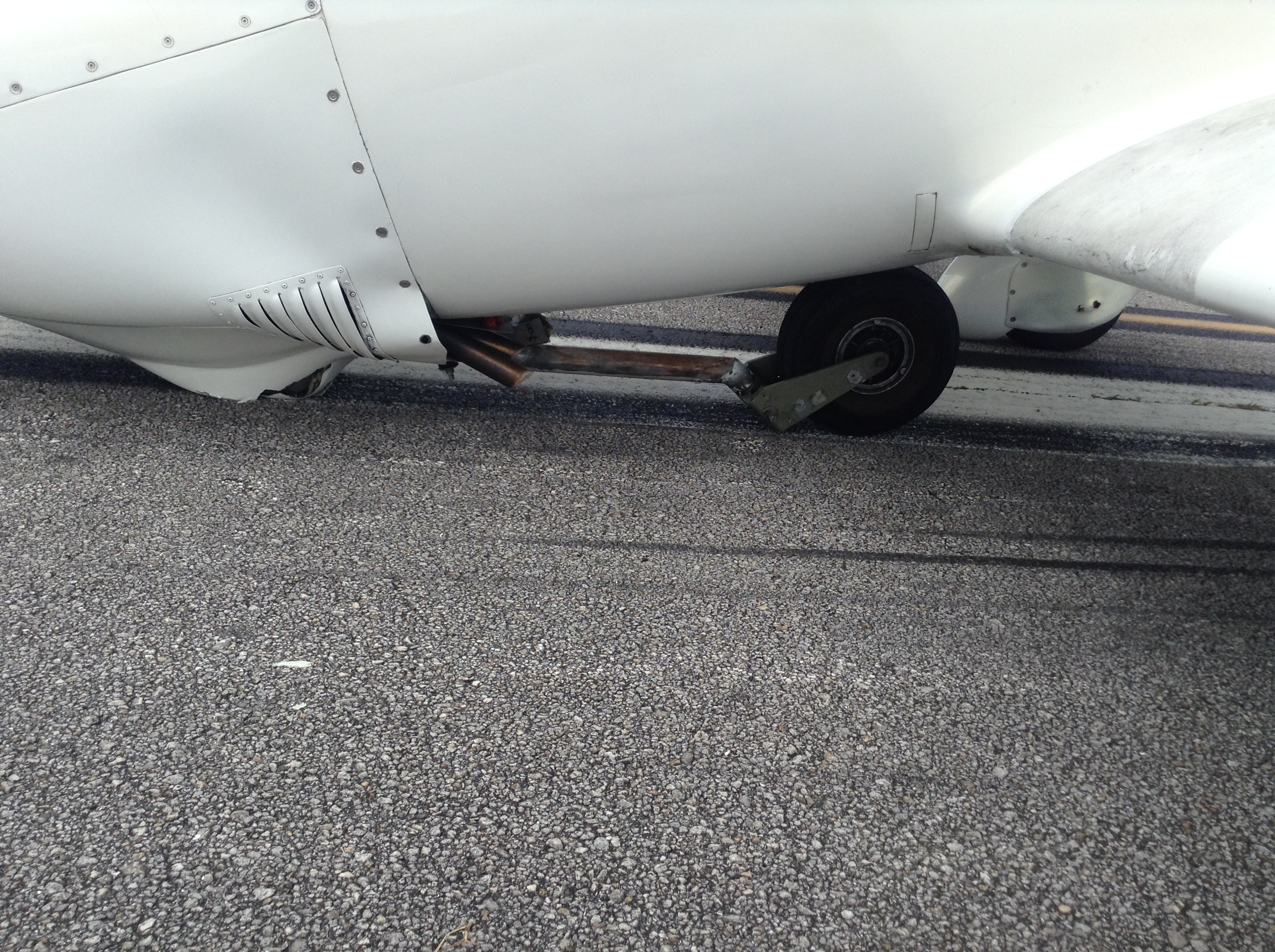

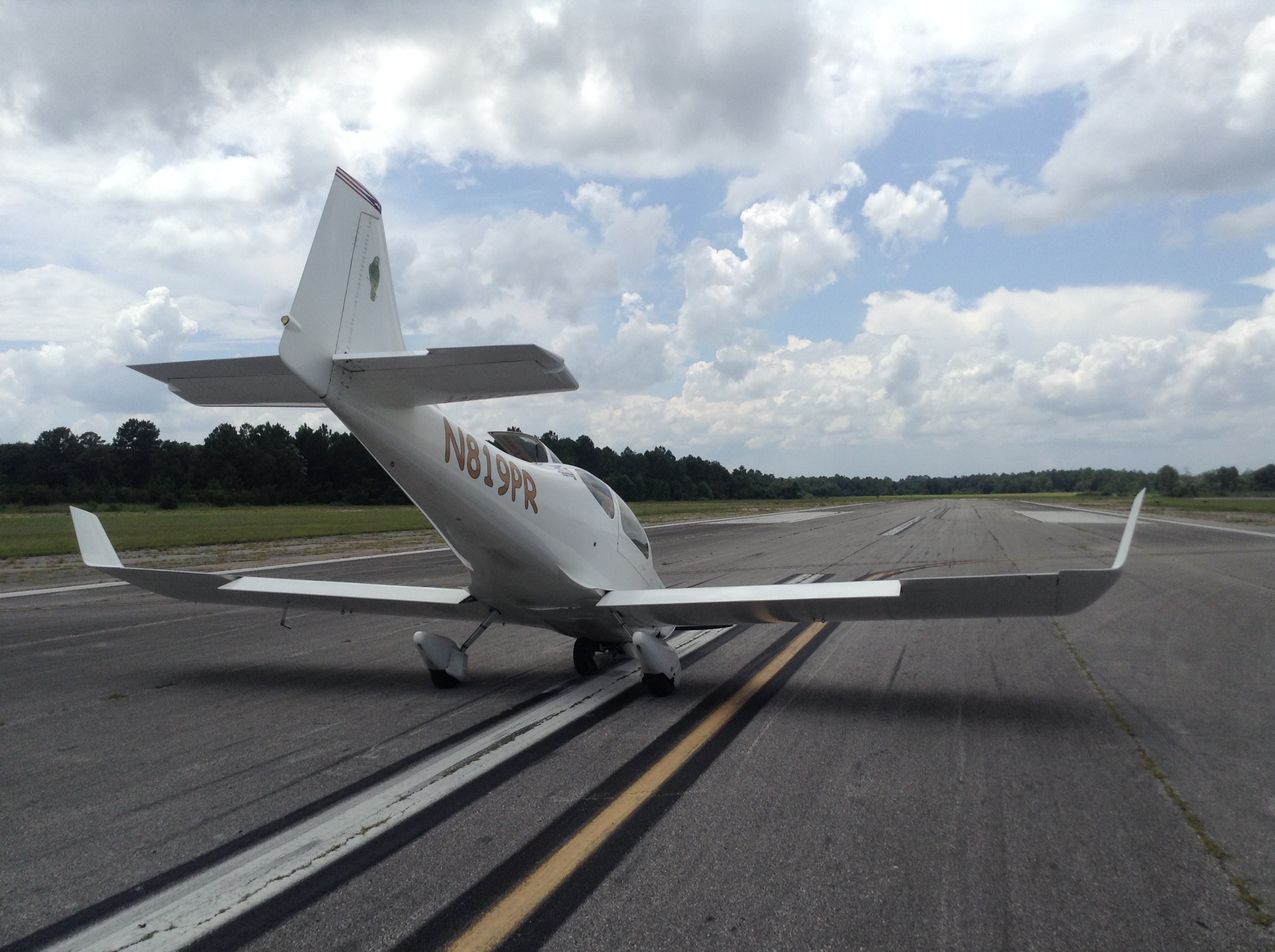

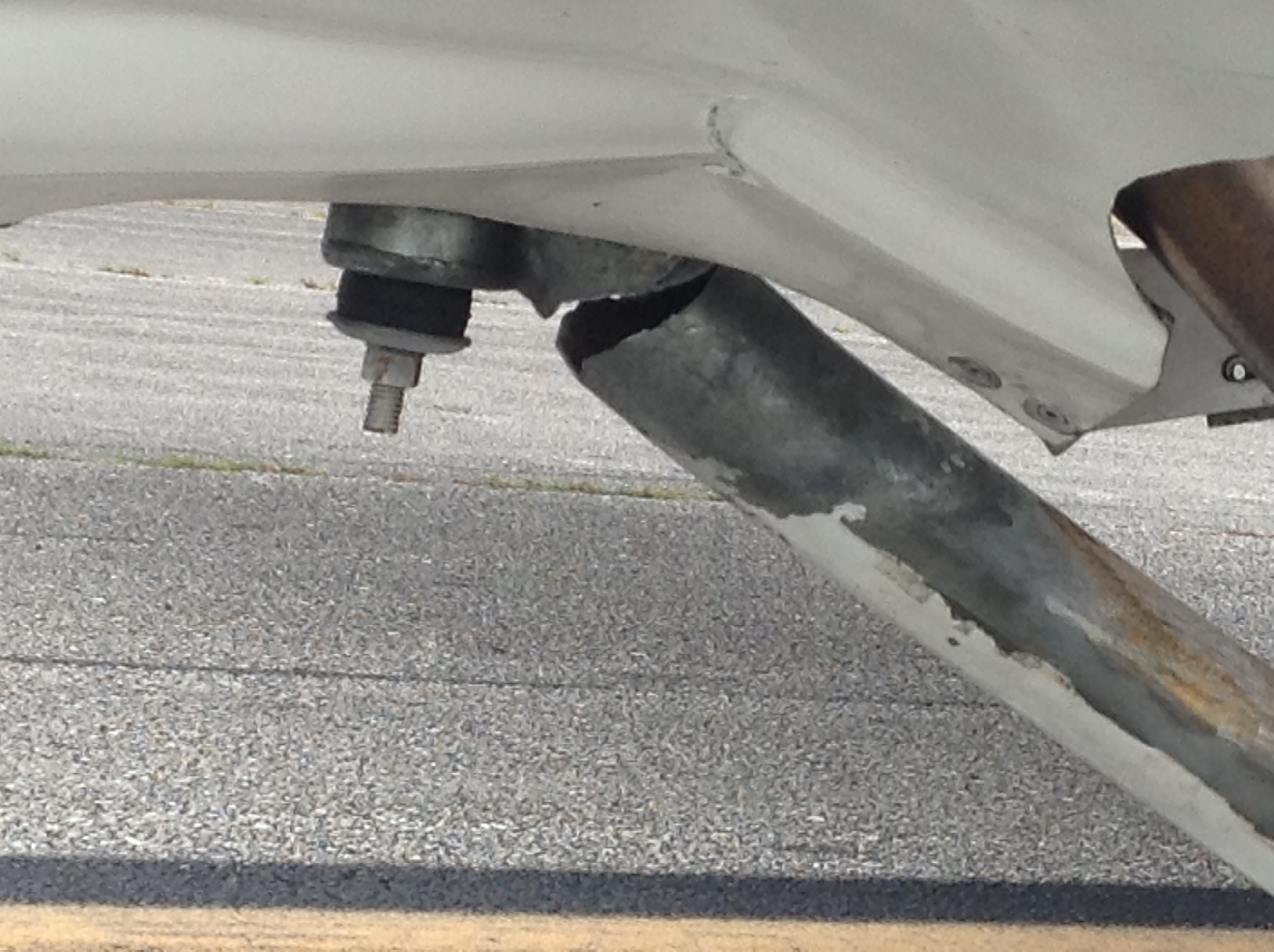

Yesterday, after a day of flying, the nose gear on my TR-4 failed just before I exited the runway. The landings (three that day) were super smooth, which is not very common for me. I am not a mechanical engineer and didn't sleep at a Holiday Inn Express but preliminary check looks like the front pin on the nose gear assembly failed. When I went to make the right turn off the runway, the rear pin then failed which let the entire assembly rotate 180 degrees to the left. Once the assembly was 180 degrees off center the tube couldn't hold the stress, it failed and the whole thing collapsed.
The worst part is if I would have taken the previous exit it would have happened on the non-movement area of the airport. But since I taxied to an exit closer to my hangar it happened on the runway so now the FAA is involved. Like I said, "Murphy is alive and well in aviation".
Depending on the firewall condition it could cost more to repair than the insured value. When the insurance company tells me what they are going to do about the claim I will make a decision to repair or to part the airplane out.
Here are some photo's of the airplane on the runway.

I am sorry to hear about this. I know how close you were getting to your around the world trip and hope that this is just a minor setback.
From the photos it looks like the damage should be isolated to cowling and engine. The engine will be the big hit since the engine was running and the resulting prop strike will probably require a full disassembly inspection.

I know how your feeling , since i had a nose gear failure on my KIS (2)
just after i completed her . It was a very bad nights sleep for me , and
even worse after the insurance man turned up , since it doesn't take much
for the insurance company to consider a right off , but i was not accepting
that and made a deal with them to settle for a lower amount plus the plane
back . in the end it took an engine strip down and rebuild, new Prop, a new
nose gear from Lyle ,a bit of glass fibre and paint and she has been flying
great for the last 11 years. The engine strip down showed no internal
damage and was completed for just 3500 pounds ( 5.5K$). it took me 6 months
to get back in the air but i ended up about 6 K pounds in profit . i would
be surprised if there was any damage to the firewall from a slow taxi nose
gear failure.
The good thing is that the airframe and wings were not damaged, take the
wings off , rent a trailer and get her home and into the workshop , pour
yourself a stiff drink and make a list of what is required to get back in
the air
Engine strip and rebuild( 6K), (plus maybe 2K for parts).
New Prop and spinner (8K)
New Nose gear (1K)
Bit of paint ( 1K )
Repairs to the cowling (1K)
Labour ( if you can't do it yourself ) 5K max
Seriously consider making a deal with the insurance to get back the plane
if they tell you it's scrap . even if you cant do the work yourself there
are plenty of people out there with the skill who can.
Does any body know if Lyle is still making parts ? and does anyone want up
update/ correct my estimates above .
Keith
aviation".

Hi Galin,
Good to hear the airplane is back in the hangar. At least this happened close to home.
The RV-10 gear may not be any heavier. The cruiser nosegear is nearly 40 lbs. A grumman tiger gear may work too if you can find one. The AL prop is pretty heavy. You could save 15+ lbs off the nose by going to the whirlwind ground adjustable prop and be able to tweek the pitch for best performance.
I am sure everyone is very interested in seeing more detailed pictures when you are ready for that.
Scott
aviation".

Initial check by the mechanic indicates no firewall damage at all, so the actual damage is not a big deal. Engine will be completely overhauled, a new nose gear installed, a new propeller installed, some fiberglass work done and the airplane will be better than before. The airplane is a whole lot stronger than it looks.
The rear pin on the landing gear "H" bracket broke letting the entire assembly rotate 180 degrees backwards. Once this happened the main tube held up for a little bit but eventually collapsed under the different stress. I will ask Lyle if he can make the landing gear rear pin a little bigger to better withstand the landing loads.
I will definitely look at moving the main gear an inch or two further forward but not sure if it can be done at this stage. The other option is to go with a CATTO composite prop, which is lighter than the SENSENICH aluminum prop I have, but composite props and rain don't mix very well and I fly real IMC.
