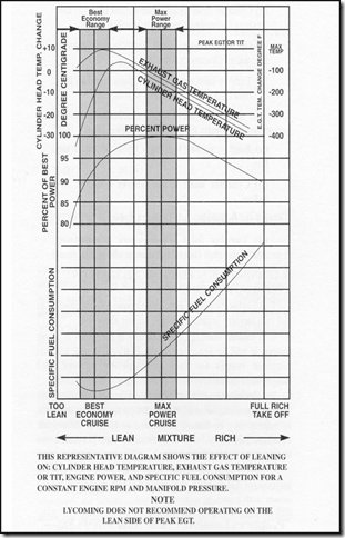

Read through Lycoming’s Key Operations- found on the lycoming site. Plenty about leaning at 75% and lower and even a chart that says they do not recommend LOP, but on the same page has:
pg38
6. Leaning to best economy mixture.
a. Set manifold pressure and RPM for the desired cruise power setting per the aircraft POH/AFM.
b. Lean slowly in small steps, while monitoring instrumentation, to peak TIT or maximum allowable TIT, whichever occurs first
[img]cid:3B93739FEA40497897A78D3550E4E0BE(at)pascalPC[/img]
than on pg 39:
Once cruise power has been set, leaning to best economy should be standard procedure as damage to the engine will not occur from leaning at cruise power settings.
pg38
<image[3].png>
than on pg 39:
pg38
<image[3].png>
than on pg 39:
Kelly McMullen
pg38
<image[3].png>
than on pg 39:
partner14
pg38
<image[3].png>
than on pg 39:
Don A. McDonald
pg38
<image[3].png>
than on pg 39:
pg38
<image[3].png>
than on pg 39:
