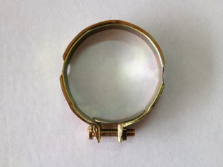

Hello Rotax list members.
Does anyone know where I can buy the clamp for the carburetor rubber socket on the Rotax 912 engine. I do have the rubber sockets but no clamp. Do not want to order the new rubber just to get the clamp.
Johann G.
Iceland.

PostPosted: Fri Aug 15, 2014 12:25 pm    Post subject: Re: Clamp for the carb rubber socket Reply with quote
How do you have new sockets without a new clamp? Rotax carb sockets come with clamps.
The old clamps are gold and the new clamps are silver. You can use the old clamp if you put an 8mm spacer in on the screw. This will keep you from over tightening the clamp.
I see you live in Iceland so some of the below may not apply.
I hope these new sockets aren't JBM carb sockets or some other aftermarket part. Looking the same and being the same are two different things. I have seen several lately and they are not up to standard. The rubber gets too soft when hot, the carbs do not snap into place near as well. I just had a Sky Ranger in my shop. The clamps were down even past the 8mm safe stop. I put my fingers against the carb while I was checking something and it came out of the socket way to easily. I did the same to the other side and it did the same. I showed the owner the difference on a Rotax carb flange and he made me change his out back to a Rotax part. If you squeeze the out side ends of a JBM socket it is very soft and squeezable when hot and the Rotax is not. The Rotax rubber carb flange has deeper recessed groves so the carb seats in much tighter and doesn't easily push out of the socket. The Rotax socket holds the carb in better than the JBM even without the use of a clamp on the Rotax flange.
There will be a new article out on the Rotax-Owner forum blog shortly about liability and aftermarket parts. It is worth reading. Even if you own an Experimental aircraft(in the US) you can still be held liable for
sub-standard parts. It would be very easy to prove and hold you the owner up for at least a partial liable payout. The MFG of the part will be on the hook, but so would you.
