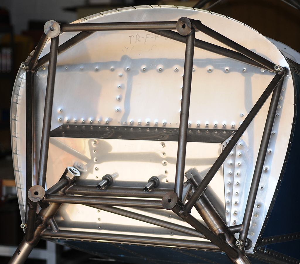

Very sorry to hear about the accident. Mark Frederick can probably give you some pointers (f1boss(at)gmail.com (f1boss(at)gmail.com)).
There were problems with the early F1 Rocket mounts, leading to the introduction of the Indy mount option (pictured). The Indy mount is very strong, but I’ll be keeping a very close eye on it, given that my operating strip is grass and not exactly smooth.
[img]cid:7A8F553A-78EB-41FF-BB5A-A8C9428F1ADD(at)Home[/img]
Cheers, Stu
Cheers, Stu
