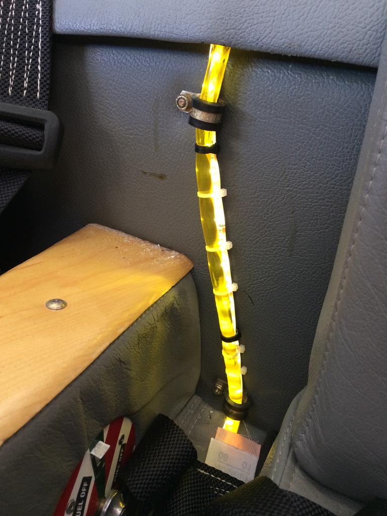

I did add a string of LEDs behind the new sight gage when I replaced the old, leaking, fuel tank:
[img]cid:FE4EF72C-C1CA-4328-8D00-339B2F6EE51E[/img]
While doing that I used the remainder of the LED string inside the tunnel for work illumination. No pictures of this, but I can take some next visit to the aircraft if anyone is interested. I’m also considering the addition of another LED string to the interior aft fuselage, behind the “D” door for additional interior work illumination. The LEDs provide plenty of light, can be dimmed and use very little power.
