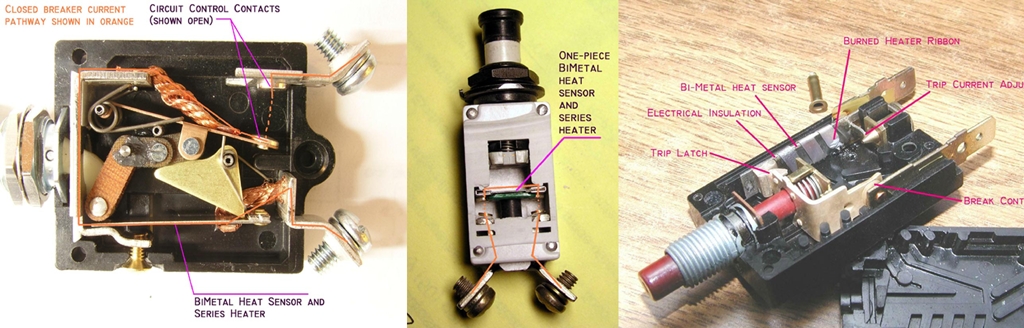

That's a pretty broad brush . . . SOME breakers are less robust than we might like for use in an extra-ordinarily abusive environment. Consider the inner monkey-motion and parts count of the switch-breaker (on left) and the commercial, off-the shelf appliance breaker on the right . . . with the military qualified device in the center that is RATED and TESTED for thousands of high-fault current trips without degradation of performance.  I've never encountered a pre-mature failure in this style breaker when used solely as a circuit protective device and not a crew-operated power control.

2) The classic "breaker for every wire" seems old fashioned and indeed breakers sometimes
pop in commercial a/c and nobody notices. An LED warning on every breaker seems to be a great idea.
Three points to ponder here. Legacy design goals call limiting failure effects to one system only. It's generally not a good thing to have one failure take down multiple appliances. Hence, one protective device per feeder.
If a protective device operates then some system is off line as a result. If nobody notices, then that appliance is not being used. As soon as the crew expects that appliance to be available, the popped breaker will, no doubt, be noticed . . . whereupon Plan-B for that failure will be implemented.
Adding indicator lights to breaker/fuses only complicates the monkey-motion built into the device. It does not reduce risks to comfortable termination of flight. It might be a troubleshooting aid . . . but then . . . you already know that appliance is inop or you will know before next flight . . . it's on your preflight checklist . . . right?

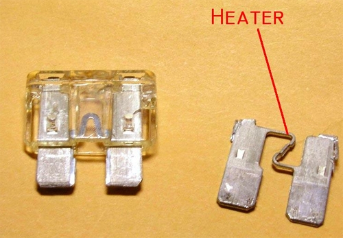

Exactly. This question prompted an essay published in Sport Aviation 21 years ago:  http://tinyurl.com/o9joztv  The decision process for circuit protective philosophy has almost nothing to do with convenience or the performance issues unique to devices being considered. To be sure, devices like this http://tinyurl.com/oka6z2a may offer some unique opportunities for adding some appliance to an airplane but in general, a clean piece of paper design should strive for minimum risk, minimum cost, minimum complexity, minimum weight in that order of prominence.
[img]cid:.1[/img]
. . . at the present time, I'm unable to suggest a superior alternative to the rudimentary fuse for keeping all the smoke inside your wires . . .
