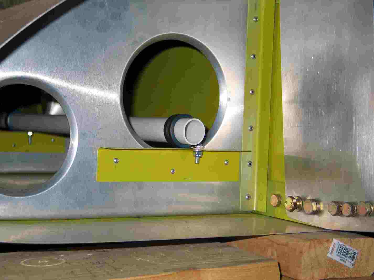

Michael,
You can always use lightweight PVC conduit to be sure that the wiring stays
in a safe place. I attached mine to brackets on the ribs with adel clamps.
The big benefit is that you can postpone the wiring until later in the
build. It's also very easy to change wires without unzipping the wing skin.
(Photo Attached)
Graham Kirby.
601HD

peterd(at)metec.co.nz Guest
Posted: Wed Jun 28, 2006 9:05 pm Post subject: Wing Wiring |
Graham/Michael,
With respect, and wishing to make sure you don't tred on the toes of
officialdom, it may be prudent to check that any applicable fire
ratings for PVC usage are observed. I recall PVC burns with toxic gas
emissions. Other listers may be better aware of any local constraints.
cheers
Peter Dunning
CH601HD
