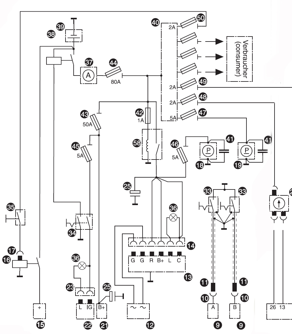

The Rotax 914 wiring diagram shows an integrated generator with external regulator-rectifier and an external alternator with built in regulator. It looks like the integrated generator is disconnected from the battery (by relay) when the master is off but the external alternator remains connected. The text indicates the integrated generator will run the battery down if not disconnected, but does not say that for the external alternator. Does this make sense?

Sheesh. Let me try again: The Rotax (major, major manufacturer of aircraft engines) wiring diagram seems to indicate that the "integrated generator" (which has an external regulator-rectifier) must be disconnected from the battery to avoid discharging the battery when it is not turning. On the other hand, the external "alternator" (which has a built in regulator) is wired directly to the battery, indicating that it does NOT need to be disconnected to avoid running down the battery. Is this consistent with you knowledgeable folks' understanding of these sorts of generators and alternators?

On page 110 of the Rotax 914 installation manual (July 1 2008) http://www.flyrotax.com/portaldata/5/dokus/d04273.pdf
The wiring diagram has a master battery contactor that disconnects the battery from the aircraft electrical system including both alternators.
The rectifier/regulator that controls the integrated dynamo has a terminal "C" that senses system voltage and enables the rectifier/regulator. It could run down the battery over a period of time.
The external alternator has a terminal "IG" that powers the field. It would also run down the battery if left on.
Joe

Thanks Joe and Ken. Joe's answer I believe answers my question. I was thinking that circuit was just for the warning lamp. Didn't know it was the IG wire that would run down the battery.
That brings me to another question: What do those warning lamps typically indicate? A negative current? There's one for each of the two charging devices. Also, I have heard that these lamps must be incandescent (not LED). Unfortunately I cannot not find a answers to even these basic questions in the Rotax reference materials.

Short answer: Yes, this is consistent with the
way these two critters work.
BOTH devices are alternators. The word "dynamo"
has been often used to describe the built-in, permanent
magnet devices common to all Rotax engines, Jabiru,
et als. The one built into the 912 engine is a single-
phase device that requires a special rectifier/regulator
to convert the wild-frequency, wild-voltage output
from the alternator into stable DC.
Here's one of several conversations that have transpired
here on the list about PM alternators and their rectifier/
regulators . . .
http://tinyurl.com/mpxxech
If ROTAX is still using the Ducati rectifier/regulator
I'm familiar with, this device DOES draw milliamps
of current back-fed into the output wires when
then engine is stopped. But if you configure your
P/M alternator to drive the electrical system
DOWNSTREAM of the battery master relay, then the
alternator is powered down when the master switch
is opened and the powered-down draw is eliminated.
The other device is legacy wound-field technology
wherein the regulator is small enough to be included
inside the alternator . . . as on most cars.
The b-lead terminal of the wound-field alternator
is the (+) output terminal from an array of diodes
that prevent any back-flow during power down. Hence
the b-lead CAN be left connected to the battery
at all times . . . cars do it. But it's not been
done in T/C aircraft that I know of.
Suggest you consider a Z-13/8 architecture . . .
http://tinyurl.com/kgg8nva
. . . . which describes a recommended architecture
for your pair of alternators (the wound-field alternator
shows an external regulator . . . your internally
regulated alternator works there too).
The two alternators and their regulators are described
in the AeroElectric Connection which is available
for about $20 from a variety of sources . . . or
you can download here
http://tinyurl.com/pt97pha
What airplane are you building?

At 09:27 2014-11-12, you wrote:
Thanks Joe and Ken. Joe's answer I believe answers my question. I was thinking that circuit was just for the warning lamp. Didn't know it was the IG wire that would run down the battery.Â
The warning output from these simple regulators is
generally limited to showing that the alternator is
not turning (broken belt) or output failed (broken
wire).
[img]cid:.0[/img]
The exemplar schematic for the PM alternator warning light (2)
shows that the light is dark any time the alternator is
rotating and delivering some voltage . . . even when that
voltage is too low to charge a battery or run your accessories.
The preferred methodology for detecting alternator
insufficiency is LOW VOLTAGE WARN set to light a lamp
any time the bus is less than about 13.0 volts. A
lead-acid battery system cannot rise above 13.0 unless
   regulators . . .

At 07:23 2014-11-12, you wrote:
Yes (probably)
If you have the external alternator connect it to a battery and
measure the standby current for a definitive answer.
Most vehicles leave the alternator connected 24/7 and they usually
draw an acceptable couple of mA drain. Sounds like that is the case
for your unit although I also have been appalled by the
documentation accompanying equipment from "major manufacturers" so I
would not put a lot of money on it.
For example the 40A IR Nippondenso that I use was only installed on
non road equipment and it draws 2 Amps with the motor off so this
one indeed needs to be disconnected.
Your observation illustrates the fact that not all
alternators are the same. Back in the day, externally
regulated alternators got their field current from
the switched bus in an automobile. One-wire alternators
will get their power from the b-terminal which means
that full field current will be drawn into the b-terminal
when the alternator is not running . . . but still
connected to the battery.
The condition becomes moot when you adopt the legacy
philosophy for minimizing hot-wires when the master
switch is off. This philosophy bypasses all the
risks for powered-down, parasitic currents that might
deplete the battery in a parked airplane . . . it also
goes toward achieving 'max-cold' wiring for reducing
risks of after crash fire.

PostPosted: Wed Nov 12, 2014 10:18 am    Post subject: alternator / generator Reply with quote
At 11:01 2014-11-12, you wrote:
Thanks Bob. I do have the book. I am building a Just Aircraft SuperSTOL. A previous lister said that the IG wire from the external alternator needs to be disconnected to avoid drawing down the battery, which it is on the Rotax diagram (via the master switch). Are you saying that you disagree with this and that the IG wired does not need to be disconnected to avoid drawing down the battery?
Ooops . . . sorry 'bout that. We're talking about the wound-field
alternator . . . not the PM machine. That light doesn't work with much more
intelligence than that annunciator on the PM rectifier/regulator.
It's definitely dark when the alternator is working but may
not light when the alternator is inadequate to system
needs. I don't use those outputs either.
If you're planning on ACTIVE NOTIFICATION OF LOW VOLTS then
you can simply leave the light off the panel and leave the
terminal disconnected.
But you're correct, when wired per the Rotax drawing, IG gets
disconnected when the big-alternator switch is OFF . . . so if
you plan to use the light, wired as shown eliminates the
concern.
An interesting feature of their wiring gives you no control
over the little alternator . . . it is automatically switched
ON via relay (5Cool with an unnecessary, 1A fuse in the coil
lead. This relay closes as soon as you turn on the master
switch and will stay closed as long as the engine is running
even if battery relay (3Cool is opened. Bringing engine
rpm down will slowly drop voltage on the bus . . . and
might cause the little-alternator relay to drop but
this raises all kinds of questions about the behaviors
of the ship's accessories.
The relay will certainly drop after the engine is shut
down.
Another interesting feature uses the little-alternator
output to power up one of two fuel pumps whether or not
the master switch is ON.
The 80A breaker is, in US TC aircraft philosophy, not
necessary or useful.
[img]cid:.0[/img]

PostPosted: Wed Nov 12, 2014 10:48 am    Post subject: alternator / generator Reply with quote
Thanks Bob,
I was wondering about that 80 amp fuse. It seems better to connect the bus directly to the battery. With regards to the 1 amp fuse that you say is unnecessary, why do you say that? Isn't it there to protect the wire that runs from the battery to relay 58? I think the reasoning behind wiring one fuel pump to the generator, is because the 914 relies on an electric fuel pump, and they are trying to provide two independent power sources for each pump.
On Wed, Nov 12, 2014 at 9:18 AM, Robert L. Nuckolls, III <nuckolls.bob(at)aeroelectric.com (nuckolls.bob(at)aeroelectric.com)> wrote:
  concern.
  down.
[img]cid:.0[/img]

Rick, It's the wiring diagram from the Installation Manual for the 914.
On Mon, Nov 24, 2014 at 7:08 PM, Richard Girard <aslsa.rng(at)gmail.com (aslsa.rng(at)gmail.com)> wrote:
Ken, I've been off the forum for a few weeks and just saw your request for info on the Rotax alternator (dynamo). Can you quote chapter and verse of the manual you are referencing? One of my custormers has a 912 in a JA Highlander that was down for months fixing a long list of defects found during the annual conditional inspection and the battery started the engine just fine when we were done. The 582 on my Kolb has the same basic alternator. I did a major rebuild on the airplane and it was down for over 18 months. The engine started right up when I took it out and that was with a five year old 18 AH  SLA battery.
Rick Girard
On Wed, Nov 12, 2014 at 12:47 PM, Ken Ryan <keninalaska(at)gmail.com (keninalaska(at)gmail.com)> wrote:
Thanks Bob,
  concern.
  down.
[img]cid:.0[/img]
