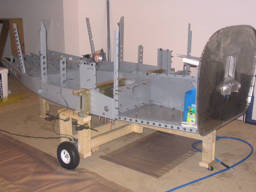

PostPosted: Mon Jun 26, 2006 7:54 pm    Post subject: RV-!0 Fuselage Dolly Reply with quote
$70! - I did mine for about $30 of which the two Harbor Frieght wheels were $4.99 each at the time. 2 - Harbor Freight 10" wheels 4 - 2 X 4 4 - U bolts 1 - 24" threaded 5/8" rod 2 - 5/8" locking bolt and washer 2 - 2.5" casters William Curtis 40237 - SB Fuse http://nerv10.com/
 Filesize:  107.28 KB
 Viewed:  537 Time(s)
