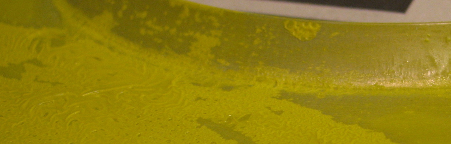

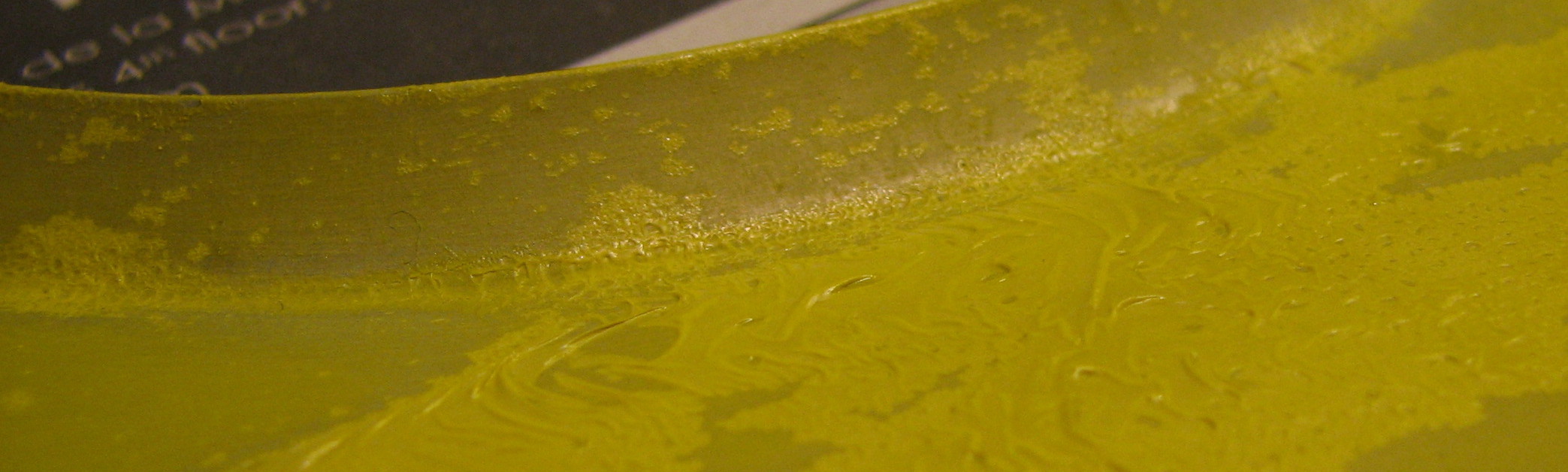

I have applied a first coat of zinc chromate to some parts with a sponge brush.
In some spots, I get an ugly effect when applying the second coat.
It happens almost immediately.
All parts where previously scrubbed with scotch brite (color to remain unidentified), and then
swiped with a clean rag. I always wear gloves while working. Cheaper than H2O2 and band-aids. And
avoids fingerprints.
Any ideas what causes this? I see no apparent pattern...

You did not say how long the drying time for the first coat was. Is it
re-emulsifying with the second coat?
Somebody out there correct me if I am mistaken, but isn't two coats of zinc
chromate an overkill? It has been my understanding that a thin film is all
that is desired.

Sometimes, too much is worst than not enough.
Just my opinion

Do you wipe down the parts with a bit of MEK before priming? If you don't
like MEK, who does, then you can try methyl hydrate.
